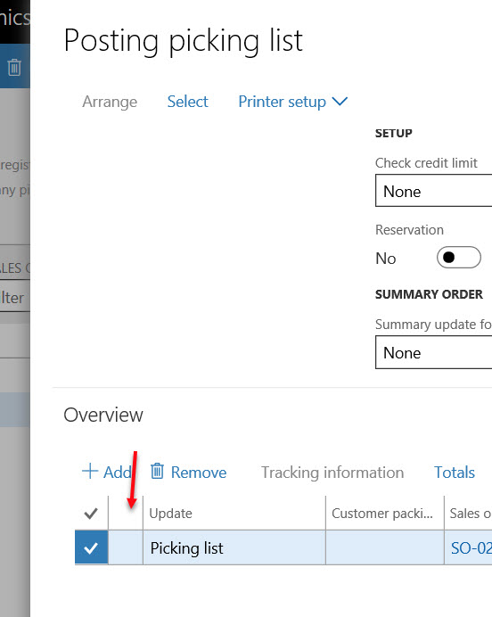

      ?just saw something I have not seen before
      anyone have any idea what an ! means in this field on the post picking slip form
      pciking list

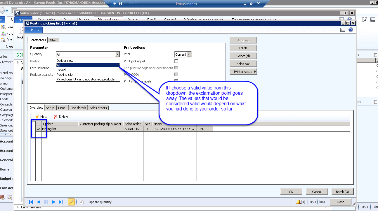

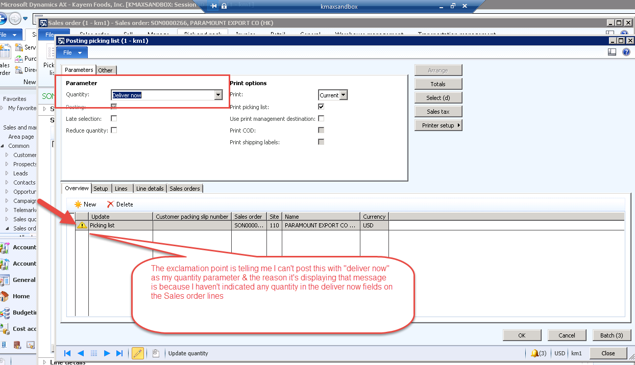

      In 2012, whenever you have aĀ posting form (pack slip, pick list, product receipt, invoice) the exclamation point is a warning that something is wrong, usually the issue is related to the quantity parameter. For example, in the screen shots below, when I set my quantity to “Deliver Now” because none of my Sales order lines have a deliver now quantity on them. I can’t tell from your screenshot, but I’m going to assume this is similar in D365. Hope this helps!
