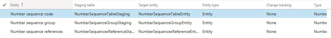

    • Vinay Nayak
      December 8, 2017 at 8:06 AM
      ?Here are 3 possible candidates for number sequence entities. I am still learning ins/out of D365 so not sure which one will fit your needs. D365 Number Sequence Entities
