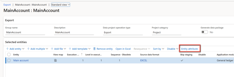

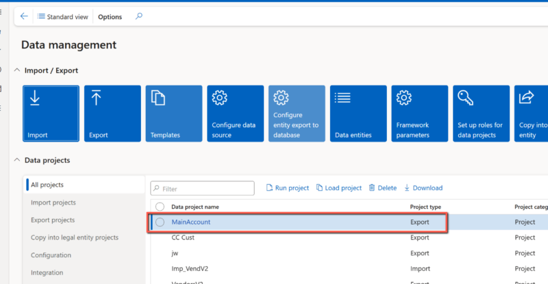

    Richard,
    There are likely several ways to do this. Here’s one of them.
    – Create a DMF export project to include the Data Entity with the field(s) you’re wondering about.

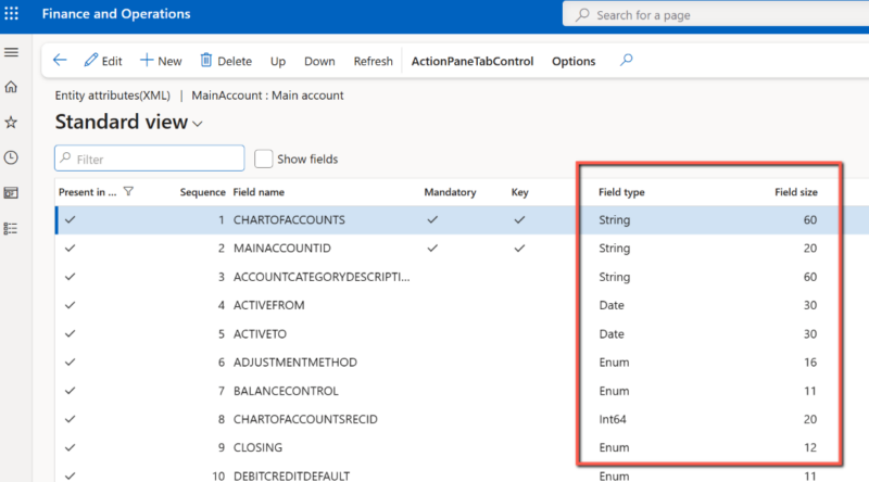

    – Click Entity Attribute to view field types/lengths.
