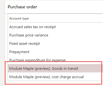

      Has anyone seen this in the item group posting form purchase order fast tab?Ā  Talked with Microsoft and no one there knows where this is coming from.

      I’m not too in the weeds with this upcoming module nor am I positive of the current NDA verbiage, but from my understanding, it is the landed cost functionality. I would highly recommend signing up on the F&O PEAP/Yammer pages when you can so you can view this material further.

      Ian is correct, this is for the new Landed cost module.Ā  The Account type names have been updated in version 10.0.17:
      Screenshot of landed cost account types from 10.0.17
      The official MS Docs are now available: Landed cost module

      Thank you for the response.Ā  Odd they changed the description to the maple thing – landed cost makes much more sense
