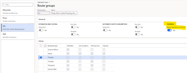

    In your Route Group, you may want to look at the settings to see if you have any “Feedback” settings enabled for RAF. See screenshot below. In this Database, SFC Routing group has the Feedback RAF Enabled. Let me know how you make out please, thanks!

      Here’s the route group setting. The flag you mentioned has been tried on and off, neither posted the route step operation as RAF when MES indicates ‘Completed’. I did try it again per your suggestion and it did not RAF the operation. Here is the current route group setting in Test:
