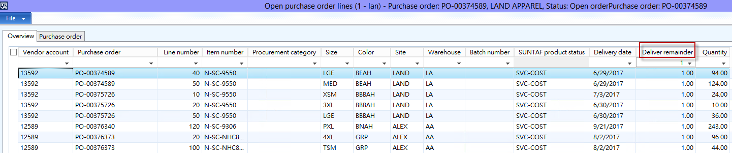

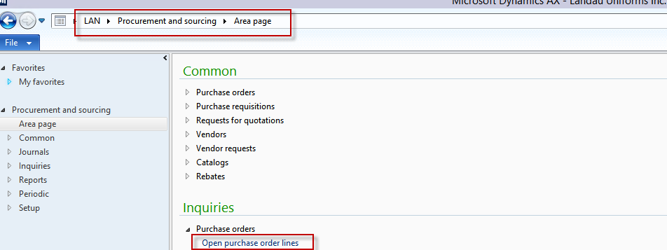

    • Grace Gillenwater
      November 29, 2017 at 10:07 AM
      ?Hi Josh.Ā
      I have not found a way to mass close out Deliver Remainder quantities on POs. I did request a customization to have the Cancel DR function added to the Open Purchase Order Lines table. I think this would save time because you can filter by multiple criteria, which you cannot do in the normal Purchase Order screen.
