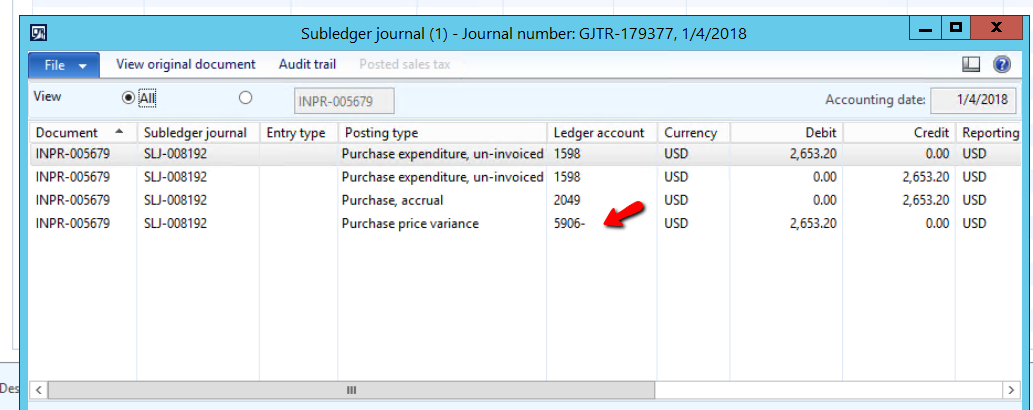

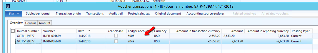

    • Andres Verdin
      October 25, 2018 at 1:18 PM
      I have the same issue, there is a dimesion missing, how can fix it? ort add the missing dimension? I’m trying either to cancel the receipt or invoice it.

    • Zvika Rimalt
      October 26, 2018 at 7:14 AM
      looks like that in your case the PO was received and later on the account structures were modified to make a dimension mandatory.
      To allow you to reverse, you will need to remove the restriction on the account structure.
