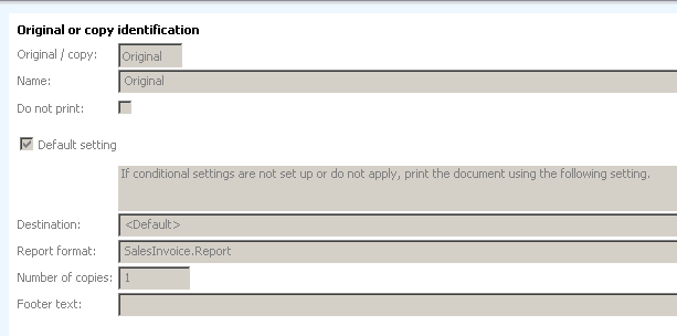

      Randy, thank you very much for the suggestion.Ā  After checking random accounts in our customer master, it seems changing the print option is not available to be changed, I’ve tried with different AX accounts with customer master access and admin access.

      Have you tried looking at the default form setup?Ā  AR > Forms > Form setup > General > Print management (button)?Ā  It will change it for all customers.
      If you want a specific customer to be different, go to the customer as in your screenshot, right-click on the “Original <Default>” under Customer invoice and click “Override” in the menu that comes up.Ā  Then change it to whatever you want.

      Hi Richard – thank you for responding.Ā  Yes, we have checked this.
