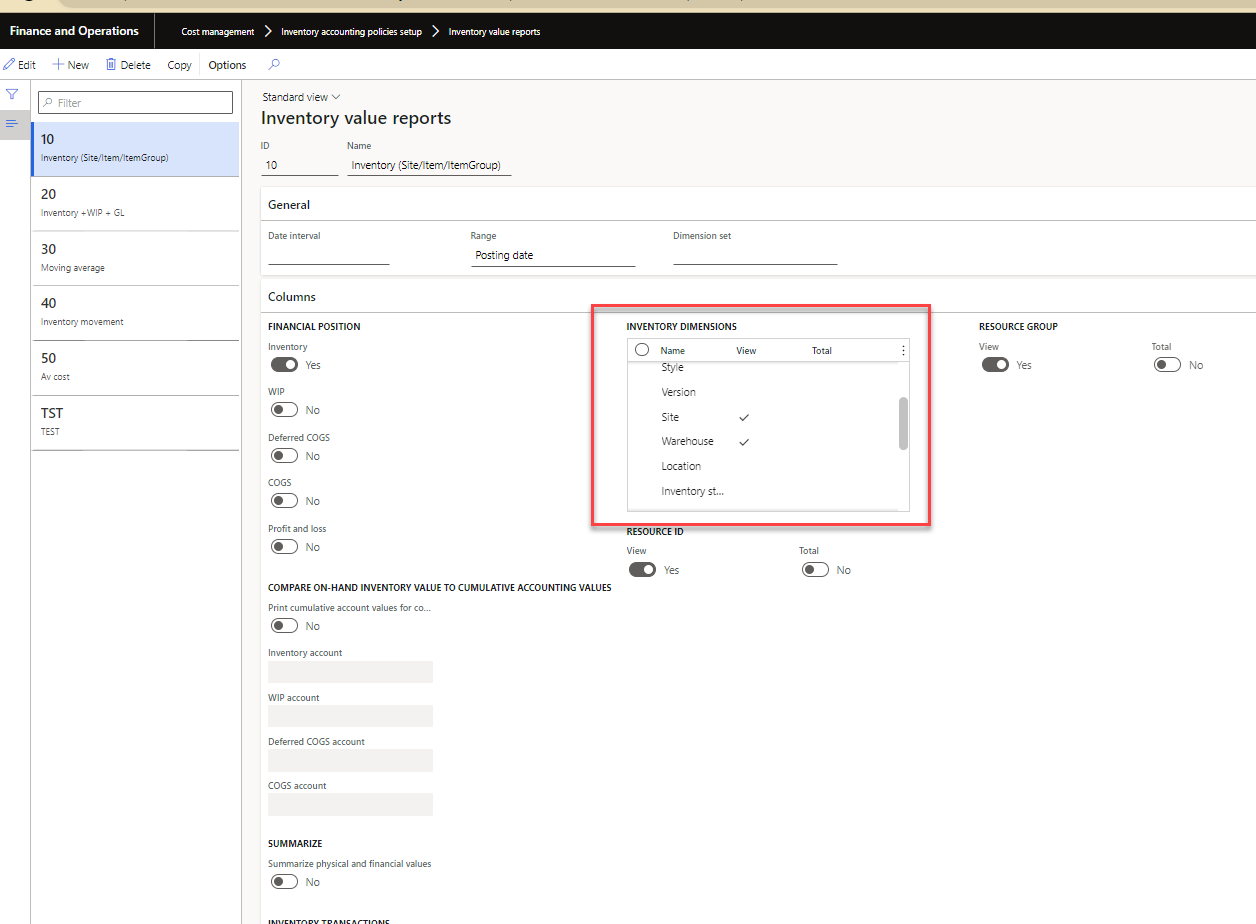

      Hi Maggie,
      When running your Inv Value report, you select a Report ID.
      These inventory report definitions are found at Cost management > Inventory accounting policies setup > Inventory value reports. Here, you can define the dimensions seen on the report:Ā

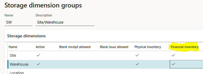

    • Duane Carlisle
      March 16, 2023 at 9:20 AM
      Hello Maggie,
      In order to ‘see’ warehouse detail on the IVR, it is necessary to have Financial inventory enabled on the Warehouse dimension of the applicable Storage dimension group(s). Site is mandatory, Warehouse is optional.
