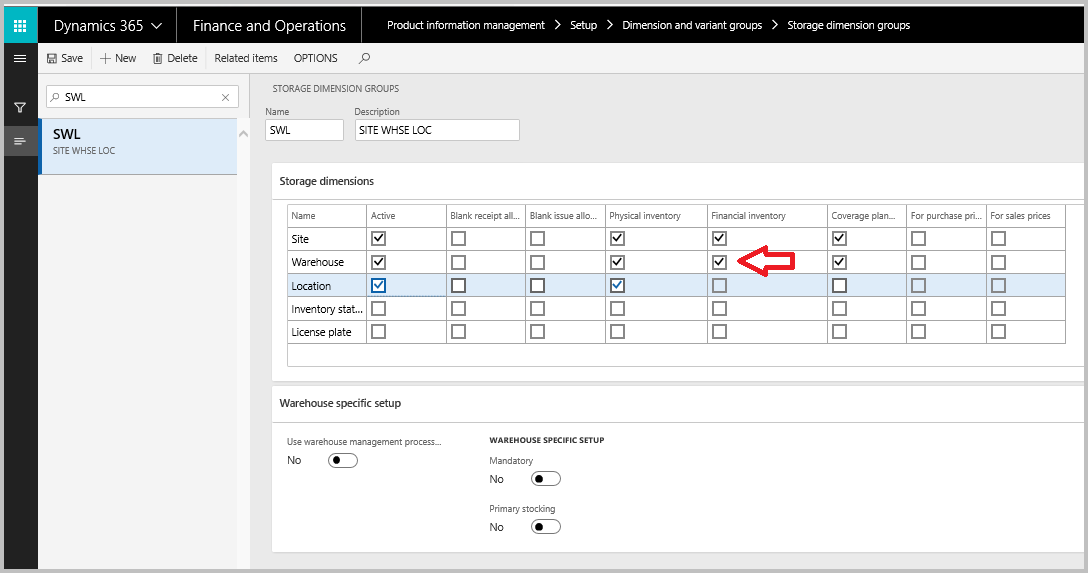

      Hi Alexis –Ā
      Great advice above.
      Another suggestion, pay attention to the Storage Dimension Group as well. The Financial Inventory by Warehouse checkbox. Several prior AXUG threads on this issue and the setting is very difficult or impossible to alter once transactions are made. Not directly related to the Inventory Model choice (Costing Type FIFO, Standard Cost, etc.) but just as important.
      I would recommend ticked (capture Financial Inventory at the Warehouse level) unless the business understands the ramifications of not capturing Financial Inventory by Warehouse.
      Thanks….Dave
