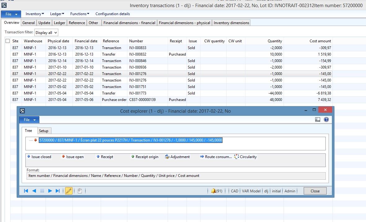

      The item uses “Weighted average date” stock model.Ā  The attached screen shows the entire inventory transaction history for this item.Ā Ā Ā  It also shows the cost explorer for one of these issues.
      A screen shot of the storage dimension group of the item is also attached.
      As we understand it,
      – The receipt from the transfer (IVJ-000832) should have been adjusted from $1450 to $1549,86 because the issuing side of that transfer was adjusted to that amount.Ā  It was only adjusted to $1519.
      – The 3 issues at $145 should have been adjusted to $154.99, but the cost explorer shows them as “open issues”.Ā Ā Ā  We don’t understand why and we don’t know where else in AX to look for an answer.
      – TheĀ “gap” in the receipt adjustment ($1549.86-$1519.90=$29.96) matches the gap in the open issues ($154.99-$145*3 = $29.97).
      We don’t understand why all these transactions can’t be adjusted correctly.

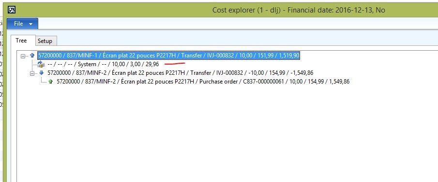

      In case it might help. here is the cost explorer for the receipt (Transfer) that was partially adjusted

      I don’t see any of the virtual inventory transactions that the weighted average models often create during Inventory close. Did you actually run Inventory close (and pre-closing) on this data yet?Ā
      Also, the screenshot doesn’t show the Issue side of the Transfer; is it showing all Transactions for that Item & Warehouse MINF-1?
      Do you have any Tracking dimensions enabled?

      Thanks for your answer.Ā  Here is the full transaction list from both warehouses, including the adjustment entry created by the weighted average.Ā  I haven’t stopped to figure out the amounts in this entry.
      No, we d’ont have any tracking dimension.
