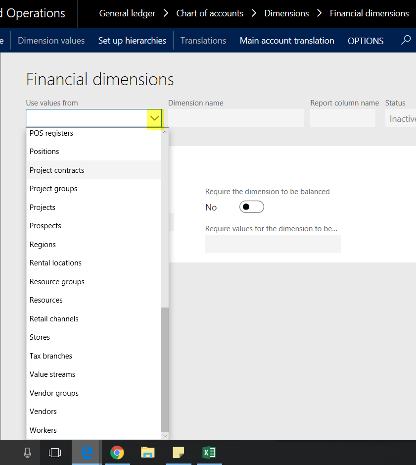

      How do I add a financial dimension name “Territory”?Ā Ā

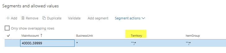

      “Territory” is not on my list of Financial dimensions.Ā  How do I add it in and make it available to choose from just like the one on screenshot 2.

      I assume that the second screenprint is taken from a System/Company where the territory is setup as a custom financial dimension, i.e. one where you have to define the territories yourself.
