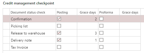

      Here’s my test scenario (with the Credit management checkpoint settings as shown in the attached screenshot):
      Credit management checkpoint parameters
      Using a customer with a credit limit of $1,000, that has no open balances and no open activity (e.g. sales orders, packing slips, etc.)…
      1. I create a first sales order (SO) with a value of $700. I am able to confirm this SO. I then create a load for the SO and release that load to the warehouse.
      2. I then create a second SO for the same customer, this time with a value of $400. I am unable to confirm this SO, because the “order has been sent to credit management.” This makes sense ($400 + $700 > $1,000).
      3. Then I post the picking list for the first SO. All good thus far…
      4. However, when I subsequently try to post the delivery note for the first SO, this process fails and this first SO is also sent to credit management.
      All the transactions and transaction attempts occur on the same day, so why am I not able to post the delivery note for the first SO?

      Grace days in the new Credit management allow for a period of time where the blocking rules get bypassed during the grace period after a successful run at that specific level. For example, you confirm a sales order, D365 reviews the order against the blocking rules as established and everything passes without a credit hold. In your example, if you can run through the other examples selected (Release to warehouse and Delivery note) over the next two days, then credit management blocking rules will not be checked.Ā
      This can be beneficial if there are long lead times on orders, for example.Ā
      Ideally, the way I understand it, your example should’ve worked. This may be worth logging a bug with Microsoft.

      A grace period adds value to the check per posting because it can allow you to only check outside of the grace period.
      I.e. If grace period is set to 7 days and a sales confirmation was updated on 1st May and a delivery note was updated on the 4th July it would not recheck the credit rules, if the delivery note was processed after the 7th May it would check the rules once again.
      The same rule applies to let’s say the cancellation of a Warehouse Management Work Order. I.e. If grace period is set to 7 days and a work order was released to the warehouse on 1 May and subsequently cancelled, then released to warehouse once again on the 4th May it would not recheck the credit rules, if released to the warehouse was processed after the 7th May it would check the rules once again.
      In your case the confirmation grace period is 2 days and delivery note is set to a grace period of 1 day and the credit check should take place after the defined grace periods for confirmation and delivery note, so according to the above explained logic the delivery note posting in your example logic it should work [if all other parameters are set correctly].
      Just curious have you setup any blocking rules for the overdue days or overdue amount under credit management setup?
