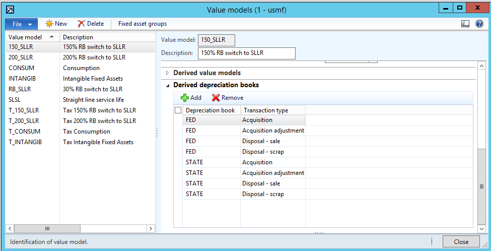

      1. Typically, companies set up one value model per fixed asset group. Ā So, for example the value model ‘MACH’ would only be used for the fixed asset group ‘Machines’. Ā This helps to organize your assets and also to distinguish them apart when running reports. Ā Each value model/ fixed asset group then has it’s own ledger account so you have better insight into your trial balance.
      2. If you want to track the tax depreciation of an asset, I would suggest using the depreciation books in combination with the derived depreciation books functionality. Ā The derived depreciation books is a nice feature as each transaction you make (under your normal value model) it also automatically makes that same transaction in the depreciation books. Ā The main difference between value models and depreciation books is that transactions with value models post to the general ledger while depreciation books are purely informational and have no effect on your general ledger. Ā Please note, you can also use derived value models as well.
