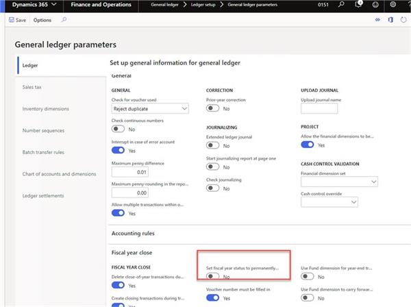

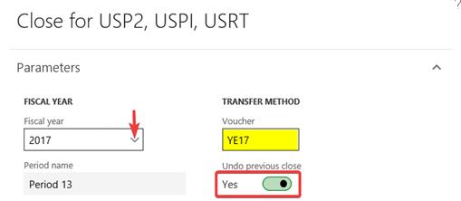

    • Ian Gorman
      February 3, 2020 at 3:45 PM
      Najeem,
      Assuming you’re on F&O.
      Step 1 – Go to GL parameters, ledger tab, ‘fiscal year close’ drop-down. Make sure ‘set fiscal year status to permanently closed’ is set to NO.
      Step 2 – When you’re closing your fiscal year, there’s an ‘undo previous close’ flag.. Select YES then click OK.

      HelloĀ Najeem JanatAli,
      I am not sure what version of Dynamics you are on but first check your General ledger parameters> General> Fiscal year close to see if you have flagged to ‘Delete close-of-year transactions during transfer’ to a yes.Ā  This option allows the system to delete prior closing/opening transactions when a new closing is created.

      1.Ā  Can you tell me if the periods for last year are in a state of On Hold or Closed? Ā
      2.Ā  In your General ledger parameters> Ledger> Fiscal year close do you have the flag turned on for ‘Set fiscal year to permanently closed’?
