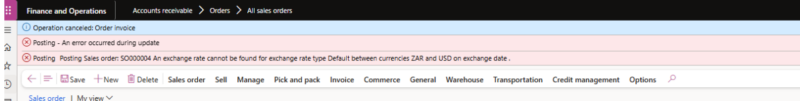

    LE Entity Currency is ZAR, System reporting currency is USD
    Exchange rates between ZAR and USD are current through 3/23/25.

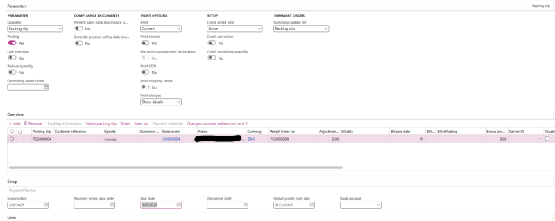

    SO packing slip transaction date is 3/23 but dated 3/1. Invoice date transaction date is 3/23 but I’m backdating it to 3/5. I am getting “an exchange rate cannot be found for exchange rate type default (default is the correct rate) between currencies ZAR and USD on exchange date.
    I can get around it by entering a document date, but we never had to utilize that field in AX 2012. Any ideas?

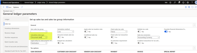

    Do you have sales tax/VAT on the sales order? if so, check what is your GL parameter value for [Calculation Date Type]

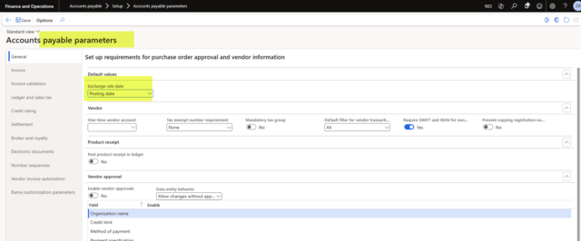

  • Zvika Rimalt
    March 24, 2025 at 6:44 pm
    Because the AP parameters form DOES have an “Exchange Rate Date” and the AR parameters form seems to NOT have an equivalent parameter it, I suspect it might be possible Microsoft “hard coded” that behaviour for AR, so it might be worth it opening a support ticket.
