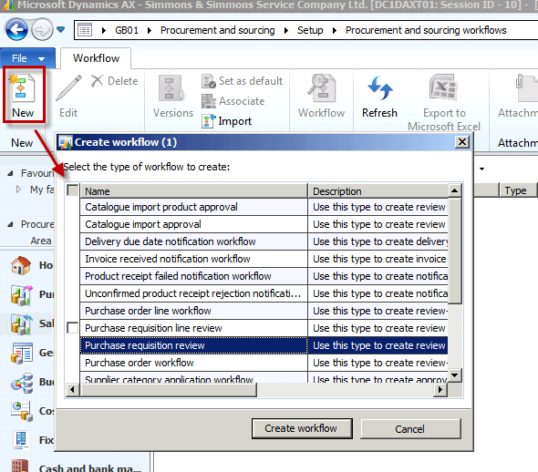

      To see an out of the box template, go to any module that has workflow (for example – Procurement and Sourcing)
      Procurement and Sourcing > Setup > Procurement and Sourcing Workflows
      This form is used to created and maintain configuration for existing workflow templates.
      When you press the “New” button a dialog opens showing all available workflow
      In the image below you can see one of the available out of the box purchase requisition workflow templates.
      Once a configuration is created, in the “type” field you can see the entity name, in this case “PurchReqReview”
      I believe you can go to the AOT find that entity and review the code of the template.
      I hope that helps

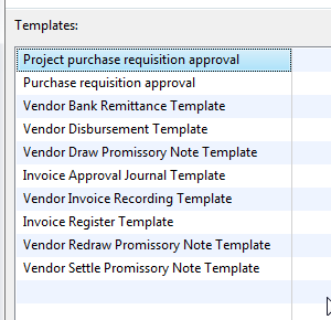

      I’m glad this came up again. I’d like a template for Item Creation but all I see are these…
      Sean Blais
      Operations Support
      Sutphen Corporation
      Dublin OH
    • Zvika Rimalt
      February 3, 2017 at 9:20 AM
      It’s a “known” issue Sean
      There are plenty of templates for approving draft transactions (invoice, requisition, Invoice proposal etc.) but few to no templates for approving creation of new entities (customer, vendor, item, bank account…)
      I keep seeing these built as a customization over and over again in AX 2012 projects, I don’t know if there is much improvement in Dynamics 365
