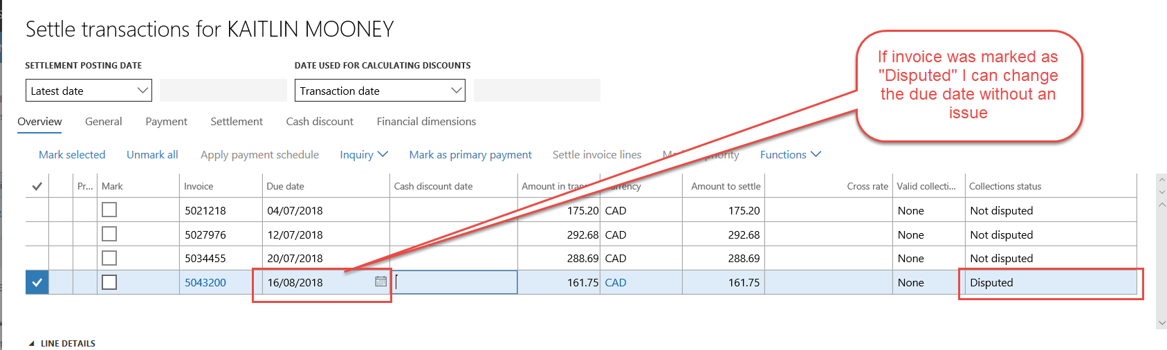

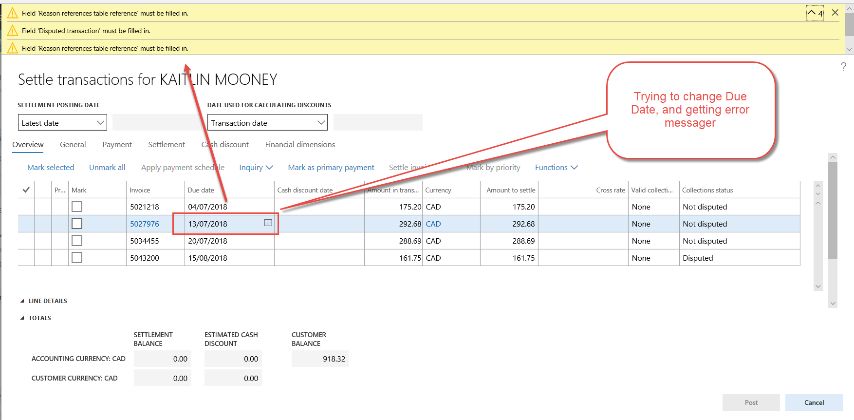

      However, we sometimes need to modify, for an existing AR invoice, the Method of Payment or the Due Date
      For that I go to AR > Customers > All Customers, and press the [Settle Transactions] on the Collection tab.
      This is the only form I found where the Due Date is available for editing.
      But when I try to modify any field on the Open Transaction I get an error message.
      To make this “intuitive” error message go away, I have to go to the Credit and Collection module, and mark the status of the line as “Disputed”

      Putting something in a disputed status, primarily removes it from the collection process.Ā  If you are generating collection letters, no letter will be produced for invoices that are in Dispute.Ā  When you place it in dispute, you can assign a resource to follow up by a particular date. I do not think that the dispute is taken off when the follow up date is reached. Ā
      I guess Microsoft has deemed that if you are changing the due date then the invoice is being disputed, so you have to give a reason.Ā  I suppose that this provides an audit trail to prevent a company from simply pushing due dates on past due invoice to make their AR look better than it is.
