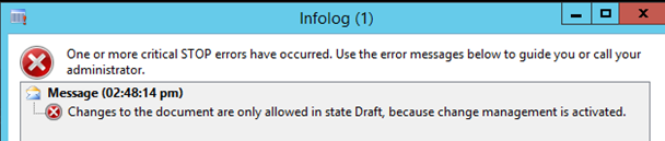

      please can any one advise whats the root cause of this error and solution:
      Error message converting PO to invoice
      Thanks and best regards

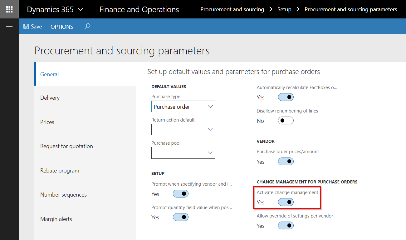

      It looks like you may have attempted to make a change to the PO and have Procurement change management (i.e. workflows) parameter turned on.
      This is located in Procurement and Sourcing parameters.
      Procurement change management parameters

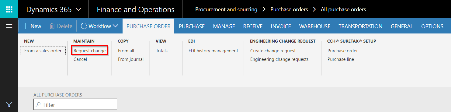

      If you want to make the change on the PO, you will need to click on the Request Change button. This will take the PO out of Confirmed status and back to Draft.
      Request Change on PO
      Once complete, you will need to resubmit the PO through Workflow.

      Thanks Chris
      was very helpful and I am also amaze the way with screen shot you explained, thank you so much
