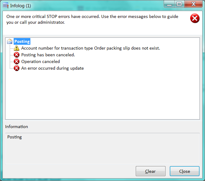

      Does anyone know what causes this?

    • Jessica Murphy
      January 31, 2017 at 10:24 AM
      Well its from a sales order I’m trying to deliver today.  It was just made today.

    • Jim Czerniak
      January 31, 2017 at 10:45 AM
      Gotcha.  At what stage of the Sales Order process are you getting this InfoLog?  Is it when confirming the Sales Order?

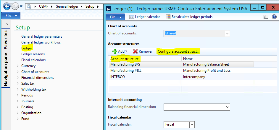

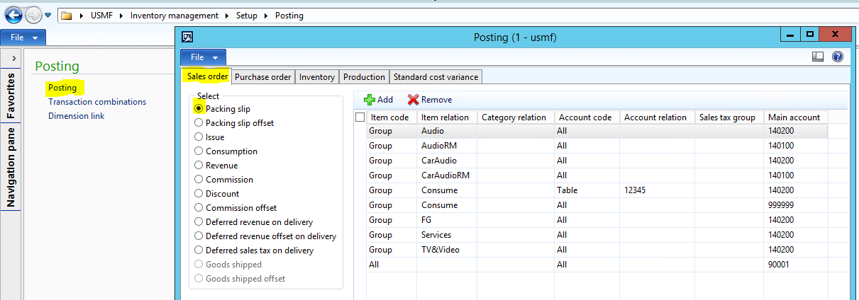

    • Chris Rusing
      January 31, 2017 at 5:57 PM
      Jessica,
      Check your inventory postings to ensure that you have a main account setup for the transaction ‘Packing slip’ under the sales order tab.
      If that looks appropriate, please check that the main account setup is included in the account structure for that legal entity’s ledger.
      Chris Rusing
      Logan Consulting
      Chicago IL
    • Paul Martin
      February 1, 2017 at 7:51 AM
      Chris is correct these types of messages are to inform you that you are trying to post transactions financially but they do not have a link between the transaction and the financial account. Any message like this the first place to look is at the posting option under setup in Inventory management.
