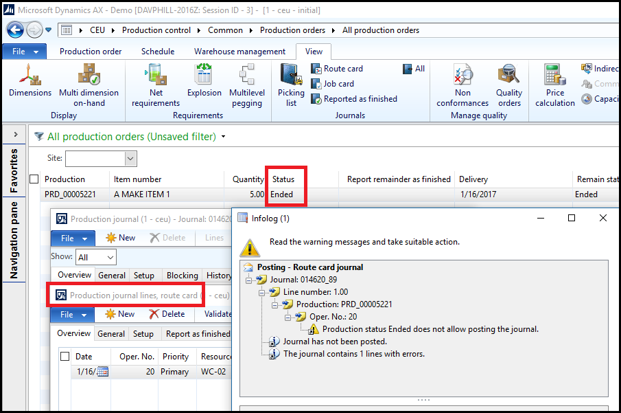

      “Ended” production orders allow for users to “create new” route cards, and have them posted. Is there a way to prevent this from happening?

      Also make sure you are looking at the correct field.  Sometimes our users have mistakenly looked at the “Remain Status” instead of just the Status and thought a Production Order was Ended when it was actually still in the Reported as Finished status.

      Hi Sam –
      You should see this error if you try to post a journal on an Ended Production Order.
      You might want to document the steps to see if a reproduction exists and also ensure a customization is not in play.
