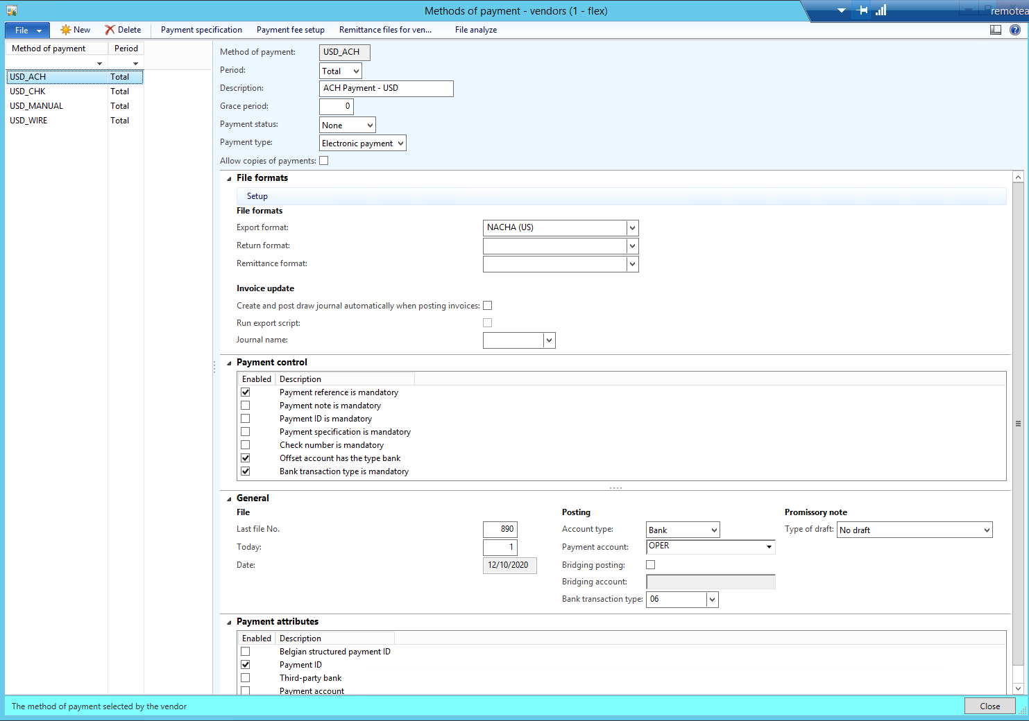

    • Dan Murphy
      July 20, 2021 at 12:43 PM
      I agree with Zvika, the first step is check with what type of file your bank accepts, it is most likely a NACHA file, which if I recall is standard in AX2012.Ā  Set up a method of payment, and when you process the file is then uploaded or sent to your bank.

    • Dan Murphy
      July 21, 2021 at 11:47 AM
      James:
      We do 2 separate runs for AP, one for printed checks and one for ACH payments.Ā  The setup I referenced is for using a bank account and not a credit card.Ā  I don’t even know how the system would use a credit card to pay AP as each vendor would have their own credit card processing company.

    • Dan Murphy
      July 21, 2021 at 1:45 PM
      James:
      Both our ACH and Checks are paid from the same bank account.Ā  The only difference in vendor set up is the selecting the different method of payment on the vendor account.Ā  I have never heard of anything like the virtual credit card system before.Ā  It sounds like you may need a custom export file created that can be tied to a method of payment.
