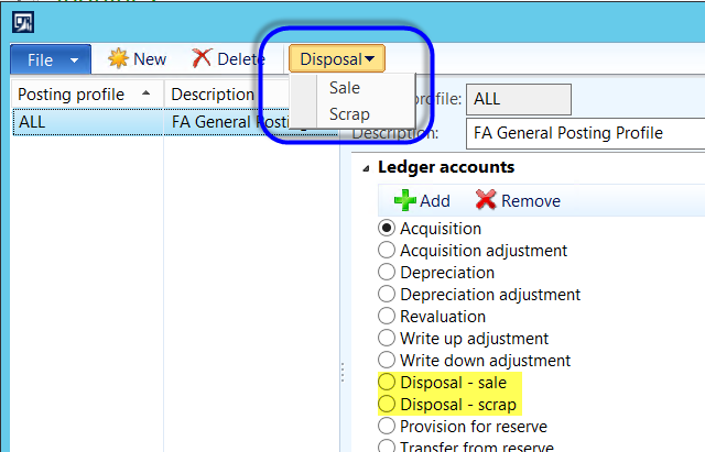

      The Fixed asset posting profiles have specific sections to set up your Disposal – Sale and Disposal – Scrap.

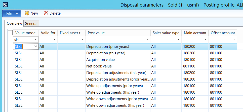

      But you must set up the Disposal parameters, you can reach them in the action bar.Ā  In this form you are removing all the transactions for the specific asset and posting it to your gain/loss for the sale or scrap of a fixed asset.
      Disposal paramters
      I hope this helps explain the error messages.
