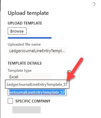

      Did you upload your designed General Journal template in D365 with a different template name? You have to use the same (LedgerJournalLineEntryTemplate) when uploading the new desinged template otherwise, the upload will successed but you won’t be able to make use of document template.
      I designed and saved my document template as (LedgerJournalLineTemplate_ST). In my example, it ends with _ST.
      Now when you upload the template, delete this suffix and make use of the original template name (‘LedgerJournalLineEntryTemplate’).

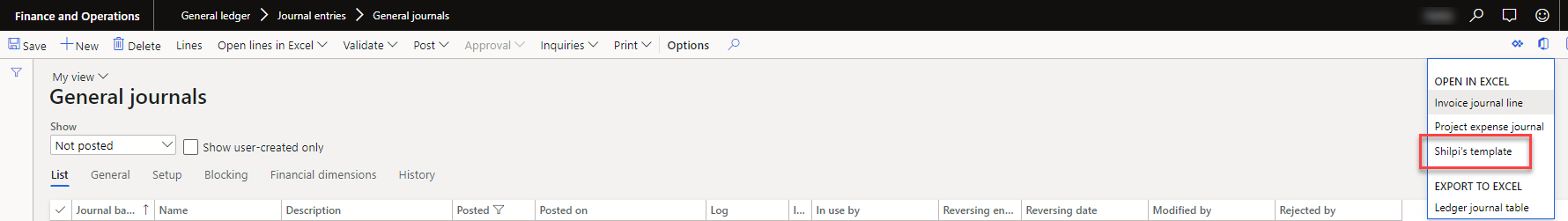

      You can also rename the Template display name as given in the screenshot.
      You will be able to see the new designed template when you use MS Office add in – Open in excel from General Journal page
      Hope this helps.

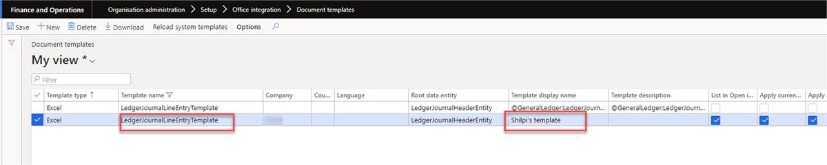

    • Shilpi Thakur
      May 12, 2020 at 6:15 PM
      Sorry I missed demonstrating that the second template is specific to the company or legal entity.
      If you do not want to override the default template used across legal entities you can add a separate designed template specific to a company. The Company then defaults on the designed template when using the import/ export functionality from Open to Excel .

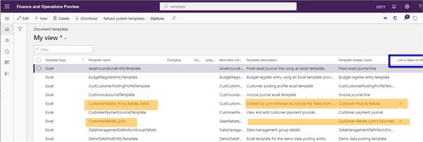

      May 13, 2020 at 10:07 AM
      I have not had a problem getting my custom templates with their own name to show as an “Open in Excel” option.Ā  Just need to set the flag on the template.Ā  See these instructions:Ā https://docs.microsoft.com/en-us/dynamics365/fin-ops-core/dev-itpro/office-integration/office-integration-edit-excel
      When will a template show as an Open in Excel option?
      When a template listed in theĀ CommonĀ >Ā CommonĀ >Ā Office integrationĀ >Ā Document templatesĀ form (DocuTemplate) has ShowInOpenInOfficeMenu set to Yes and has the same root datasource (table) as the current form, it will be added as an option in the Open in Excel section of the Open in Microsoft Office menu. The following image shows theĀ Document templatesĀ form with two of my custom templates with “List in Open in Office” ticked.
