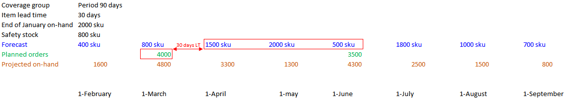

      For the Coverage Group you selected the Period type, looking forward (coverage period) 90 days? I don’t know if I’m understanding well but I think this setup should give you the result you are looking for (I try to draw it).

      Hi Jennifer, the reason for that is AX uses the forecast date as the date the inventory is required so it wouldn’t group those forecasts together to make/buy at once unless you manipulated it to do so. Someone earlier mentioned using a Period based coverage group, with your Period set to 90 days. This would mean that any demand that has a date within 90 days of the current date would only have one planned order for the entire quantity, rather than one planned order for every source of demand. This would probably be the closest to what you’re asking for.
