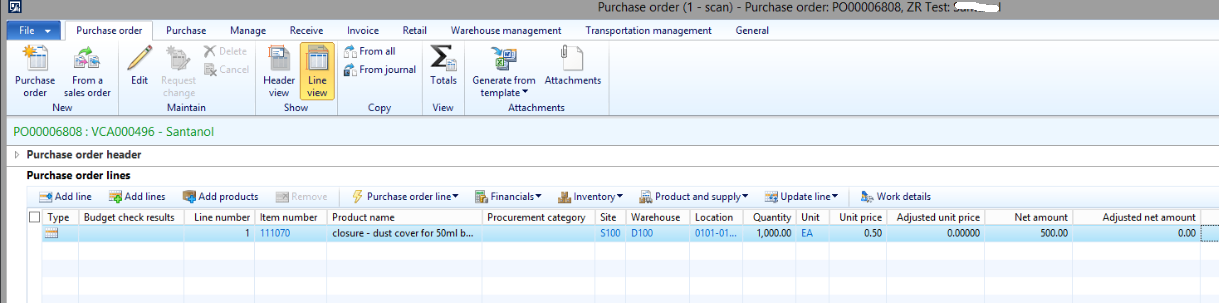

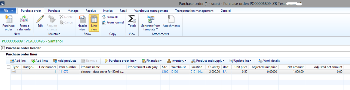

      1. Create 2 purchase orders for the same vendor

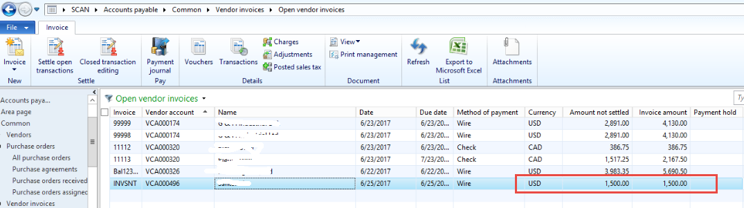

      2. Create a consolidated invoice for both purchase orders. The invoice amount is the total of the two purchase orders, as expected:

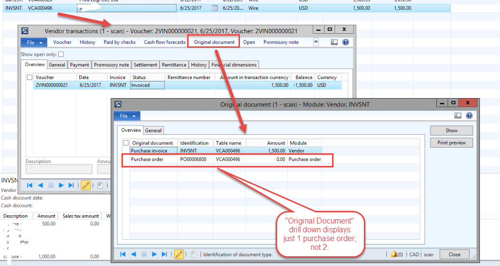

      3. When I open the invoice journal, and try to use the “Original Document” button in order to view the original purchase order, only the first PO is displayed. making it hard to know what other purchase orders are part of this invoice.

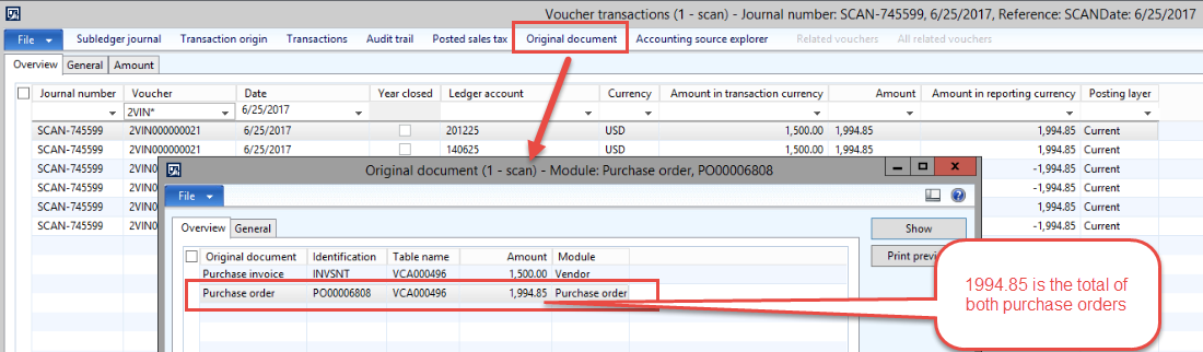

      4. Same thing happens when I try to drill down from the GL transaction back into the purchase order:
      When I go to the GL transaction for the invoice, and drill down into the original document, only the first purchase order is displayedĀ just like with the drill down from the vendor invoice.
      But In fact, in this case, it is worse, because not only AX shows me just a single purchase order, but for that purchase order it displays a misleading amount (in the image below, the amount displayed is the total amount for the two purchase orders combined, although this the PO amount is just 1/3 of that.
