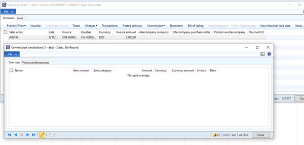

      I am not getting commission transactions on invoices.Ā  We are not live, but this is critical to ‘go live’.Ā  Am at wits end now and looking for guidance.Ā  The customer groups for commission, sales groups and item groups all seem to be established correctly.Ā  The calculations have been defined and assigned to of the commission groups.Ā  The groups all show from the customer to the sales order header and order lines like they should.Ā  Inventory is reserved, picked, registered, packed and invoiced.
      What am I missing?
      Still a rookie in AX.Ā  We are on AX 2012 R3.
      Here is a screenshot of the commission no-show:
      Thanks in advance!

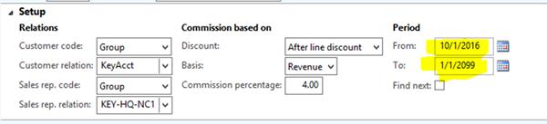

      The other information needed concerns your setup between items and sales groups.Ā  Is your matrix complex or simple?Ā  Are all item groups and all sales groups treated the same for the calculation of commission?Ā  Our company has a tiered commission system depending on product sold.Ā  The most common reason we have for no commission calculation is a mismatch between the item group, the sales group and the matrix of how much commission is paid per group.Ā  If you need more assistance a screen shot of your calculation setup may help the group help you.

      The missing field (I think) on your setup is the date range.Ā  I always setup the commission calculation to be effective the date I set it up until 01/01/2099.Ā  If for some reason I have to eliminate a sales group then I can end date that commission calculation with an editĀ so the system will stop calculating from that point forward.Ā  I think since you have no dates, the system thinks your setup is not active.

      per Debbie’s latest response – I assigned a ‘From date’ of 8/1/2019 and a ‘To date’ of 12/31/2099.Ā  Created a new sales order with all the same information then processed all the way through invoice.Ā  The invoice journal does not show any commission transactions yet.
