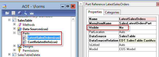

      To improve client performance, we recently disabled the factboxes, preview panes, related information, etc on several forms.  This was accomplished by changing the Visible property of all form Parts to “No”.
      When the SalesTable form is called from a specific custom form, we want to enable both of the above form Parts whose Visible property is currently set to “No”.  How can I access and change the Visible property to “Yes” using X++ code?    Thanks!

      March 23, 2017 at 9:29 AM
      See link below.
      AX2012 – How to control the visibility of FactBox on form thru X++
      Mindbrations remove preview
      Before discussing the code, let me point out that this is not recommended, since the user should have control over the visibility of FactBoxes so your design should always take this into consideration; Having said that, if you for some reason want to control the visibility, here’s how to do it: PartList partList; FormRun formPart; str formName; int counter; //formName is the name of the form that the factbox is referring to.

      March 23, 2017 at 9:40 AM
      Thanks Lloyd, I’ll give that a try!
