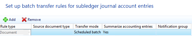

      Set up a new company. however under GL module -> Set up -> GL parameters -> Batch transfer rulesĀ  its automatically appearing:
      Unable to change toĀ
      it first time Rule type appeared as Document, usually when ever set up new company its always Company
      please advise how to fix this
      thanks and kind regards

      Hi Nazim,
      The first “company” record should be created automatically when creating the legal entity. If it is not there, then probably it had been deleted or changed by a user. The only way to get it back is using a job to create a record or data editing.
      kind regards,
      AndrƩ Arnaud de Calavon
