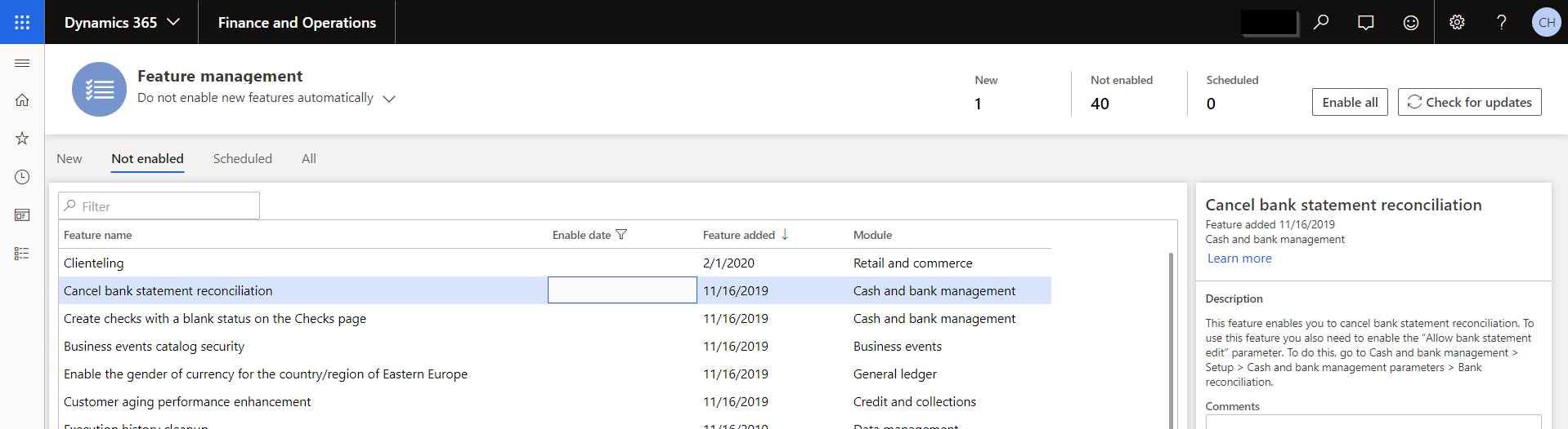

      What version are you on? Also, are you using the standard or advanced bank reconciliation
      If you are on D365 and using standard bank rec, there is a new feature release that will allow you to cancel reconciled statements.
