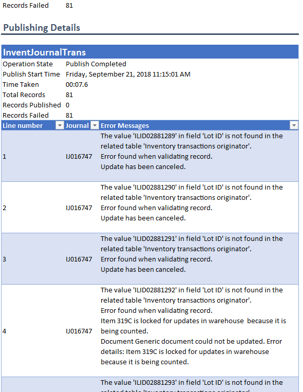

      We are on AX 2012 R2.Ā  We do an annual physical inventory, and I am looking forĀ suggestions on how to update the cost price and cost amount in the count journal to the ?weighted average amount instead of the price from the inventory master.Ā  I have tested the following with no success:
      1) Export the count journal, update the price in Excel and import it back in toĀ a new journal.Ā  This is an issue because i can’t get the inventory location to populate back into the journal.
      2) Use the excel add-in to update the price.Ā  I receive the following message when trying to publish the data back into AX.Ā  It seems to work for a journal that is less than 10 lines, but when I try to update more than that, I get this message on every line.
      Inventory count journal error when publishing udpated costs
      The only other idea I have it to enter the average cost into the price field on the items so the count journal pulls that cost, then switch it back to the actual price when I’m done.
      Does anyone have any other ideas, or successful processes for updating the price in the count journal?

    • Kimberly Tallman
      September 27, 2018 at 9:23 AM
      Amy,Ā
      Unfortunately, the counting journal is not designed to work this way. Since you’re weighted average, there are varying approaches to this. Typically though, clients update the default cost on the item itself and then make any necessary adjustments at the transaction-level at inventory close. Remember that the cost from the item master is only used (in regards to counting journals) when increasing inventory through a counting journal – you cannot modify the ‘cost’ of an item on the reduction of inventory.Ā
      Suggested steps are below:
      1. Run inventory recalc and update latest cost price on items (this is a flag on the item master).Ā
      2. If you don’t have the flag set on the items, you could either do it from the backend/run a script
      3. Perform full physical/post journals
      4. Assuming this is along with month-end/fiscal period end, run inventory close
      5. Make adjustments as-needed to individual transactions
      As always, validate the process you want to use in a Test environment first.Ā

    • Guy Terry
      October 3, 2018 at 6:51 PM
      Hi Amy,
      Don’t forget about the ‘Latest cost price’ tick box on the Manage costs fast tab of the Item. This will cause AX to automatically update the cost price on the item. You might find that this keeps it closer to the running average cost price that you are looking for.
