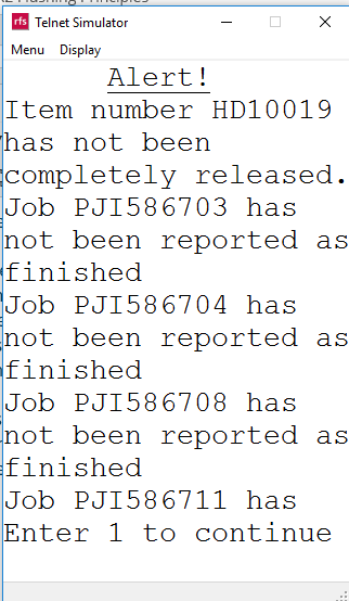

      Our assumption is that when we do the Report As Finish workflow, a pick list would be created and posted to consume these hardware parts.Ā  We are unable to figure out how to get the pick list to be created and posted.Ā  We are now receiving the message

      This usually means AX is expecting the item to have been consumed, so maybe there was a picking list that never got reported for that item so it’s saying how can we finish if we never reported our full materials?Ā

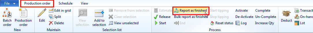

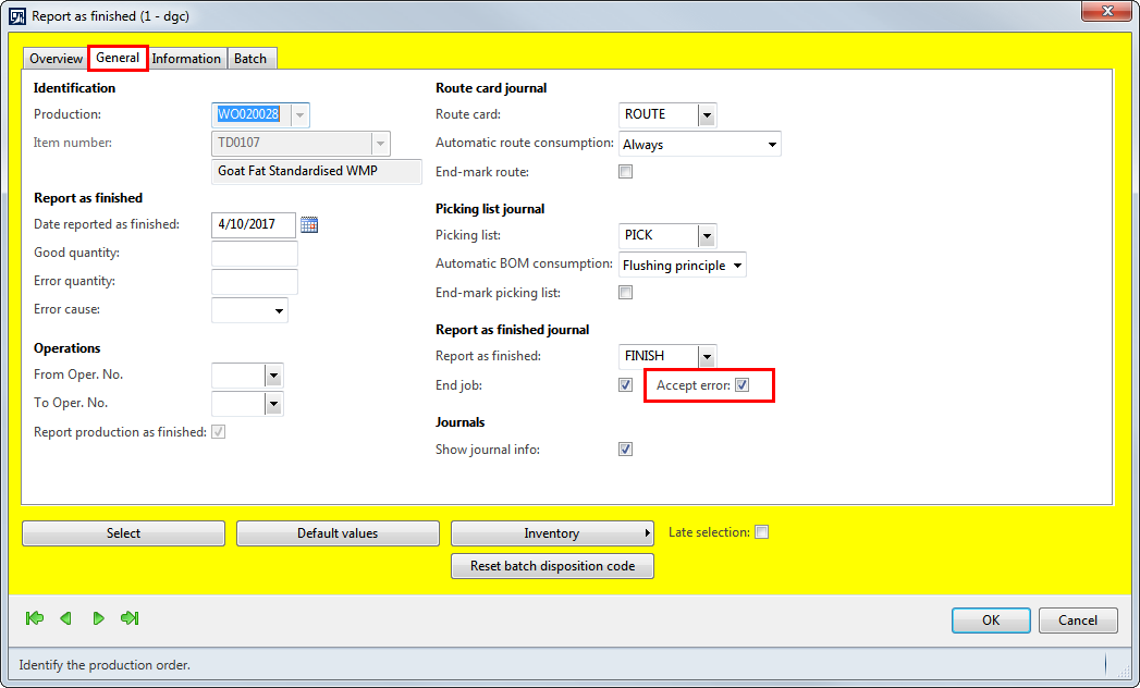

      Not sure if this will help but we often see this error from the Process > report as finished
      To get around it, you can go into the general tab and tick the Accept error tick box before you click OK.
      I’m not sure exactly what happens when this is ticked, but that is how we have done it since AX4, and we haven’t had any problems from it.

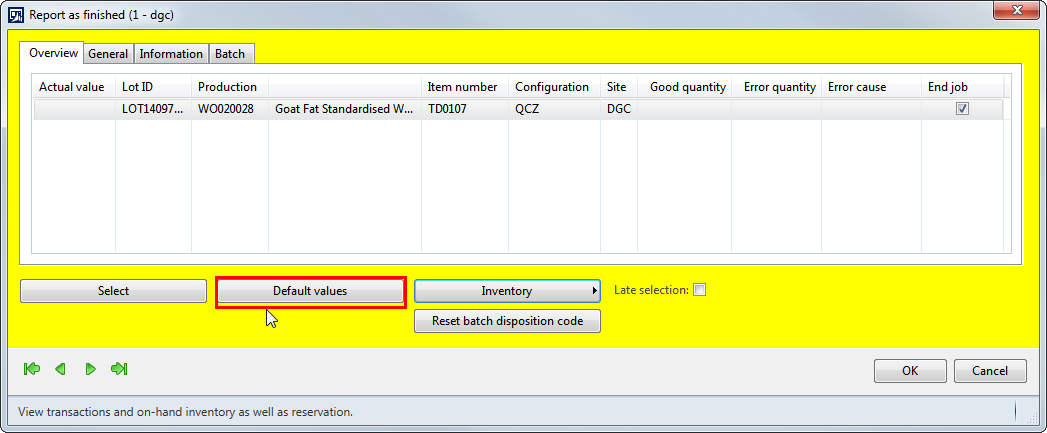

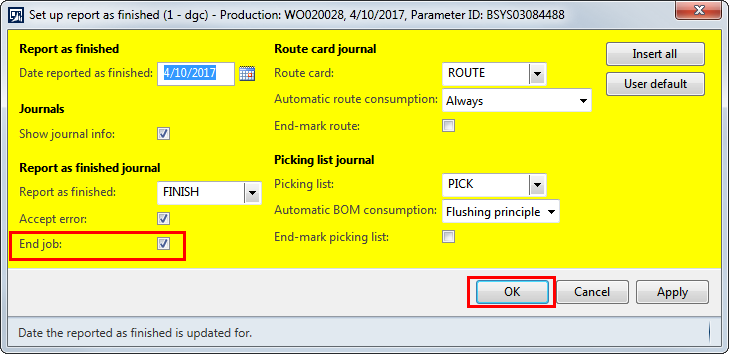

      If this works for you, you can make it default by clicking on the Default values button at the bottom, and Ticking the accept error tick box there and clicking OK, then it defaults to ticked all the time.Ā  Each user would need to do this to work for them.

      Thank you Elliott and Andrew for the comments!Ā  We were able to figure it out.Ā  We had an incorrect check box on the start production order screen and the report as finished default values needed to be changed.
