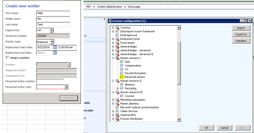

      Hello GG, Merit recently upgraded a couple clients from 2012 RTM or R2 to R3.  Off the top of my head I remember one issue that we faced that you may run into that I can hopefully save you some time with.
      Part of R2 I believe is the introduction of Personnel functionality in HR. If you do not change anything after the upgrade you will not be able to add a new worker for example, because some new Personnel functionality becomes required (Personnel action type).
      Your options are to implement the Personnel functionality, or if you just want to keep what you had in R1 you can chose to disable the new (optional) Personnel settings. See attached screenshot.
      This is also described in a white paper but basically it is just this setting (followed by resynchronizing the application).
      I will let you know as I remember any other fun adventures we faced in this specific type of upgrade.
