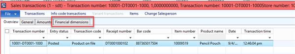

      When I get in as sysadmin I see these Tab Lines:
      But the Financial dimensions tab does not show up with many other roles I tried – it has a pageActivate method assigned to it.

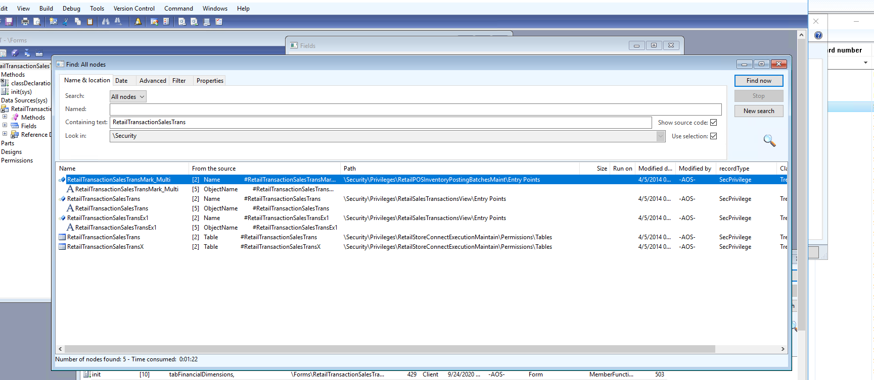

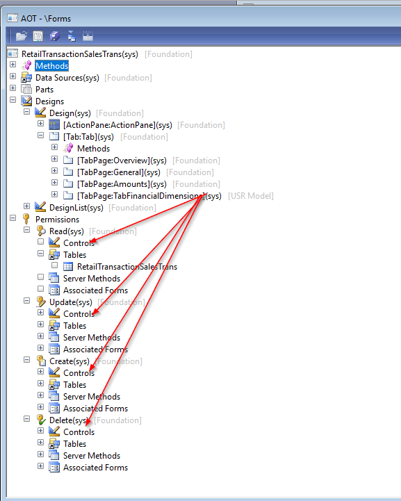

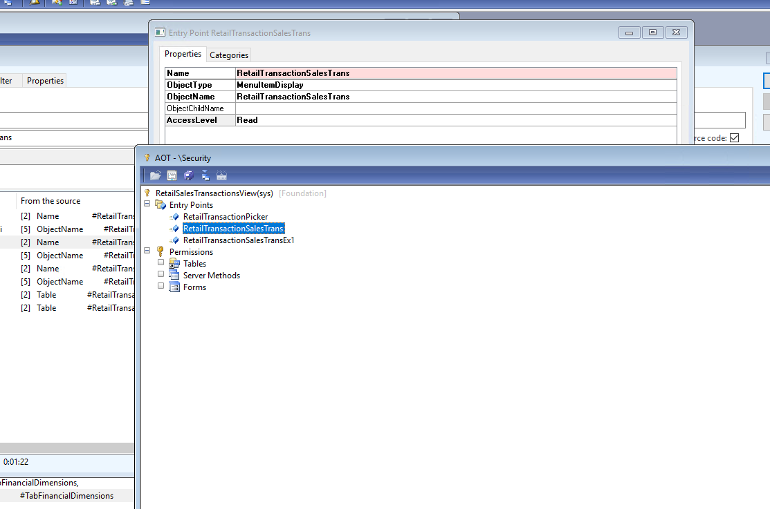

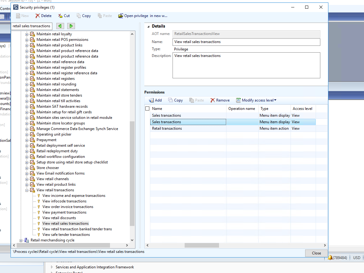

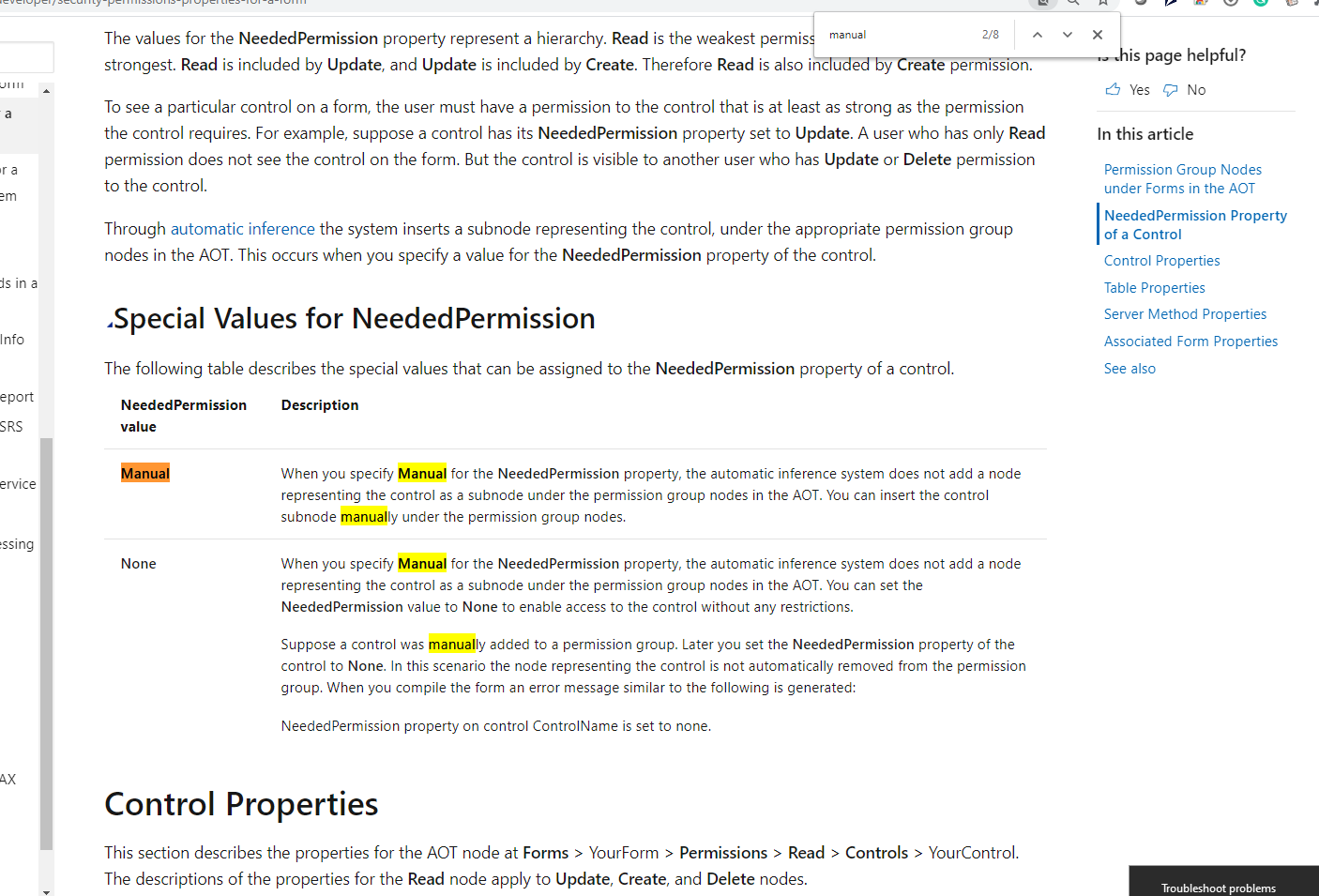

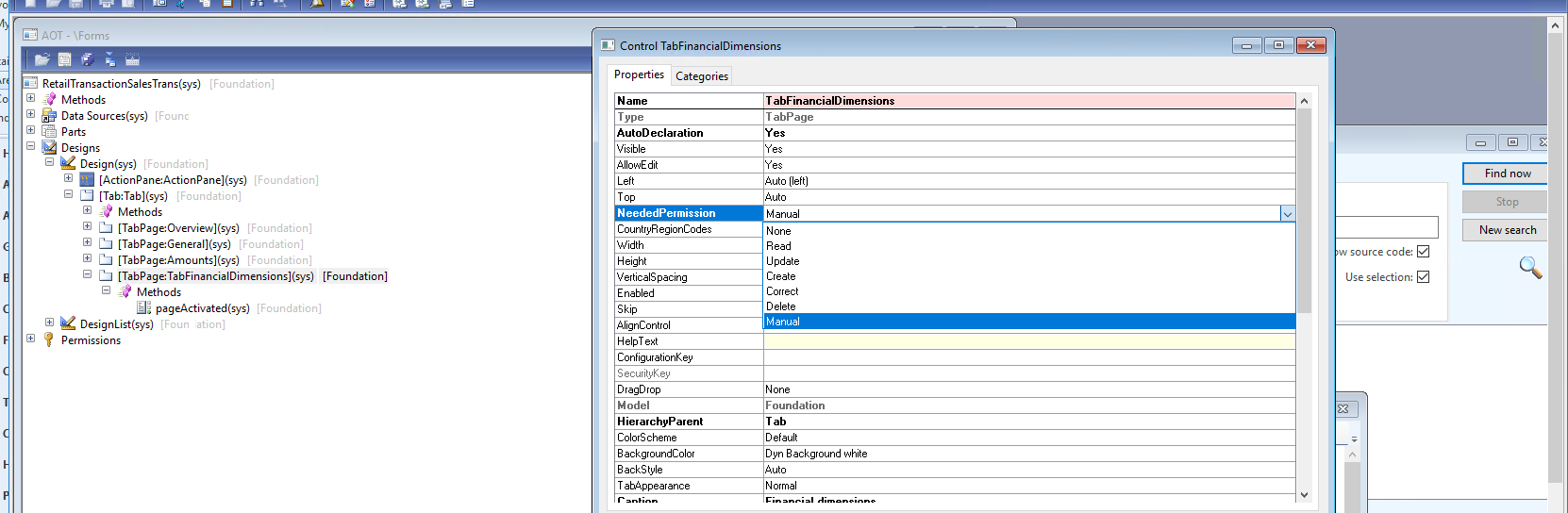

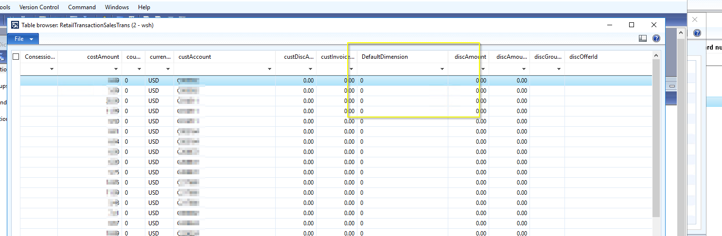

      Looking at a standard form, the Tab has “Manual” as the needed permission (image 1).Ā Ā Ā  You can edit the form to add the control into one of the Permission Groups in the form (image 2).Ā  I did a search and the only security privilege hitting this form is RetailSalesTransactionView,Ā  related to the “View retail sales transactions” (images 3, 4 and 5).
      Looking at the image you might have some development on the form “RetailTransactionSalesTrans”. Because of this I would suggest two different small development options:
      1. You could either move the control into the specific permission group you want (Read to use the current permission) or any other if you are building a new security privilege for the form with a different access level.
      2. Change the access level on the tab to Read..Ā  that will give permission with the out-of-the-box security privileges.

    • Dan Cantley
      November 13, 2020 at 11:22 AM
      Thanks for the information.Ā  This will be useful – I will start my deep dive.Ā
      I did find out that nobody other than the sysAdmin’s can see this information.Ā  I shouldn’t have assumed that when the requester said that other’s can see the data, and wanted to know why he couldn’t – that other’s could in fact see the data.
