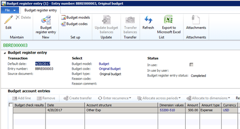

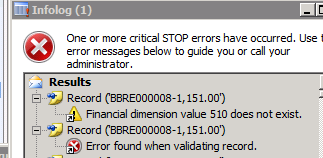

      The third dimension set is for Expenses with departments,Ā  so the LedgerDimension is 53200-510.Ā  Here is the error message I am receiving “Financial dimension valueĀ 510 does not exist.”Ā Ā I am able to type in this LedgerDimension directly in the Budget Register Entry and it does work there.

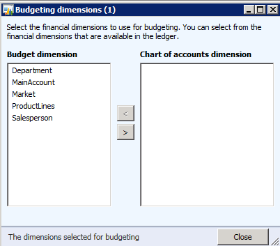

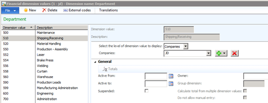

      1) The financial dimension values are assigned to the company I am importing.
      Ā  2) The financial dimension is set up as a budgeting dimension.
      3) I can manually enter this combination in the budget register entries.
