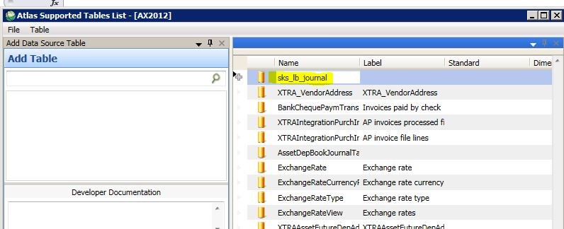

      We are currently on AX 2012 R1, using ebanking version 8.2.5.6x with Atlas 5.1. To view the SKS tables, we had toĀ delete the Atlas cache on the server along with the client’s atlas cache.Ā  We also had to make sure the individual accessing the SKS table had permissions to view the table and data.
      Have you tried to manually add your SKS table by typing the table in on the right side of table designer (see screen print below).8dw1RKc1QKeXOgXabJZt_TableDesigner.JPG

      Clearing the cache on the client and serverĀ did not resolve the problem. Adding the table in table designer does not work. That’s the problem.
