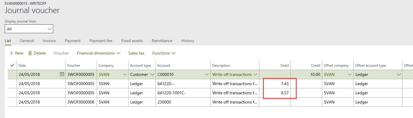

      1. I create a simple sales order for $10. sales tax = 0%. It just happens the cost (as displayed in the Sales Order “Totals” form is 1.43
      2. I invoice the sales order. an invoice for the amount of $10 is created.
      3. I use the out of the box “write off” functionality to write off the invoice.
      To my surprised, the resulting journal, instead of creating a single line for $10, breaks it to two lines: 1 line for cost, and 1 line for margin (total = $10)
      Needless to say this is burdensome for my users, having to consolidate the lines.
      Can this odd behaviour be controlled by configuration? This is a pure vanilla instance.
      and don’t get me started about the extra 0$ line created because I had $0 sales tax on my sales order (angry emoticon)

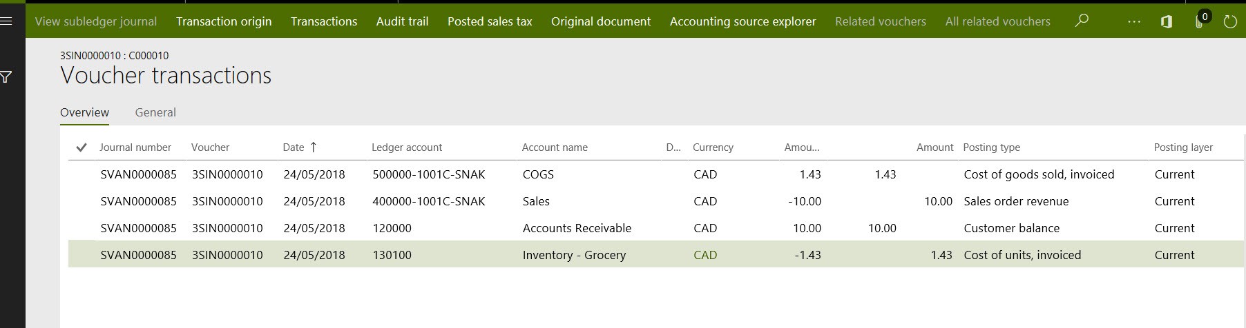

      Zvika.Ā  Can you post a screen shot of the journal for the original invoice?

    • Zvika Rimalt
      May 25, 2018 at 7:59 PM
      The only “unusual” thing is the fact there are dimensions on the COGS and Revenue account – but I would not imagine this is a very rare setup.
      As you can see COGS posted as 1.43 (which is the amount used to split the amount in write-off journal)

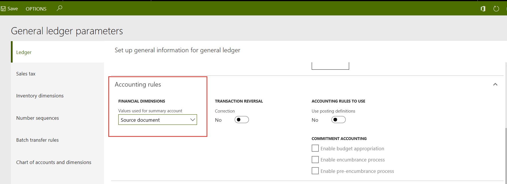

    • Ludwig Reinhard
      May 26, 2018 at 6:14 AM
      I tried to replicate it in a 8.0 PU15 system but could not manage to create a similar write off transaction.
      What might possibly responsible for this is the GL parameter ‘values for summary account’.
      Can you possibly try to change this parameter and test whether this fixes the issue?
      If this does not help and if you are able to replicate the issue I would suggest to contact the MS support because to me the write off transaction does not look correct.

    • Zvika Rimalt
      May 26, 2018 at 3:04 PM
      did you mean this parameter? Changing it to “Accounting Distribution”Ā  did not seem to make a difference.
      I will focus on re-creating it in demo data…. I can imagine what obscure configuration we made might be triggering this.

    • Kaare Boraas
      May 28, 2018 at 10:14 AM
      Thanks for posting the original journal.Ā  The only thing that really surprises me is the financial dimensions.Ā  I would have expected the reversal of the margin to use 1001C-SNAK not just 1001C as per the original transaction.Ā  Any idea why it is dropping the last component of the dimension string?Ā  Does the account structure for the write-off account not include that component of the dimension string?

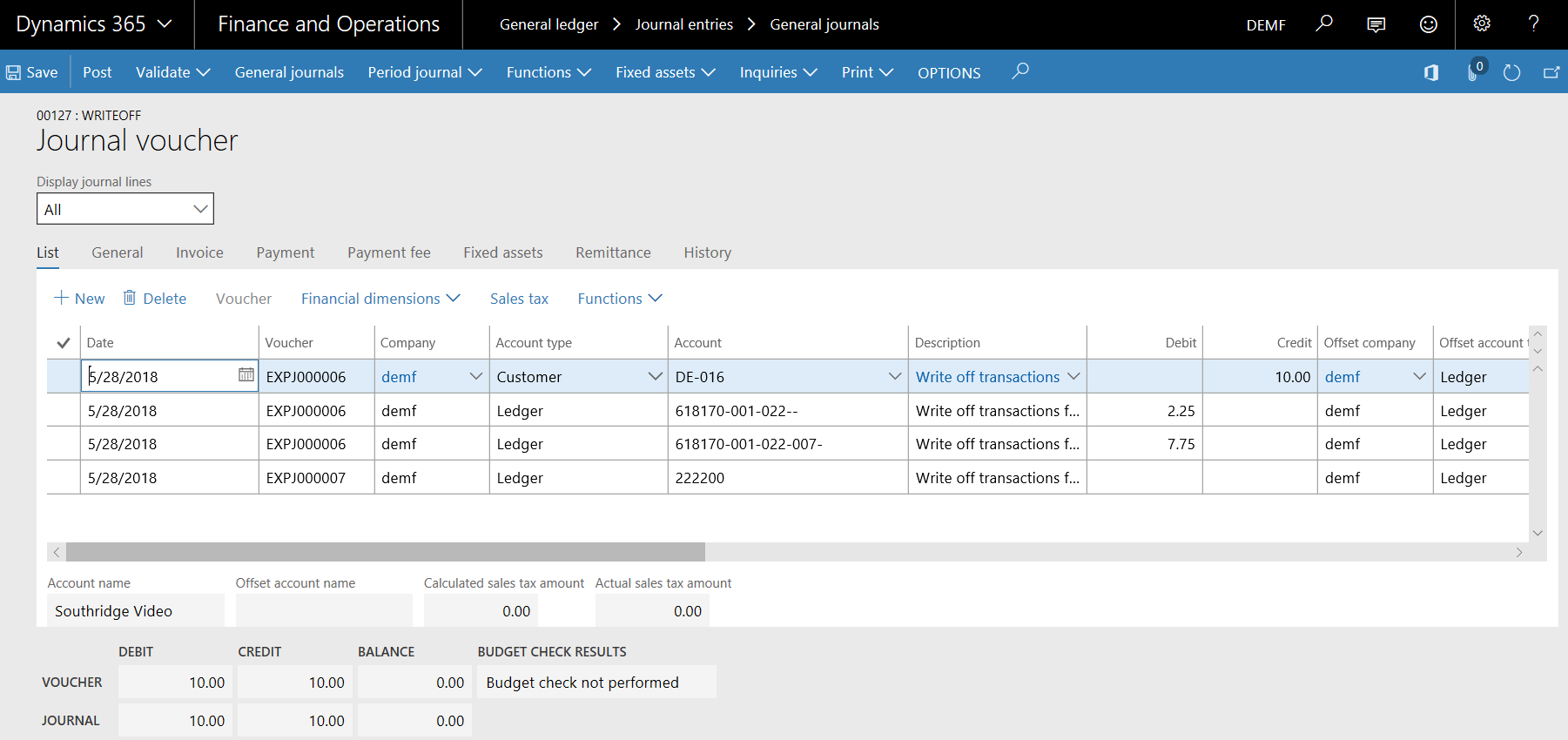

      Update: I managed to (easily) to re-produce the issue in a Demo Data “Contoso” environment, using unmodified configuration in company DEMFĀ  – so same dimensions, same inventory setup (!!)
      All 3 issues showing up in the Demo environment:
      1. split sales price/cost
      2. dimensions not copied for one of the lines
      3. Extra redundant line to recover 0% VAT, although there is 0 amount of VAT.
      Quite disappointing I must admit.Ā
