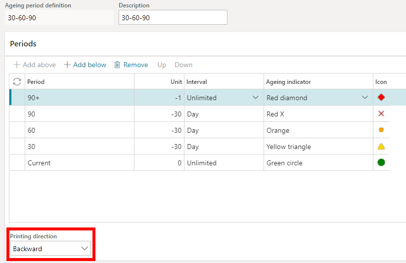

      Hi everyone,
      I am trying to build my aging definitions to get the following figures:
      CurrentĀ  Ā  Ā  Ā  0 – 30Ā
      30Ā  Ā  Ā  Ā  Ā  Ā  Ā  31 – 60Ā
      60Ā  Ā  Ā  Ā  Ā  Ā  Ā  61 – 90Ā
      90+Ā  Ā  Ā  Ā  Ā  Ā  90+
      this is how is set now:
      Period
      90+Ā  Ā  Ā  Ā -30Ā  Unlimited
      61-90Ā  Ā  -30Ā  Day
      31-60Ā  Ā  -30Ā  Day
      1-30Ā  Ā  Ā  -30Ā  Day
      CurrentĀ  Ā  0Ā  Unlimited
      and this is what I am getting
      Ā  Ā  Ā  Ā  Ā  Ā  Ā  Ā  Ā  Ā  Ā  Ā  Ā  Ā  Ā 90+Ā  Ā  Ā  Ā  Ā  Ā  Ā  Ā 61-90Ā  Ā  Ā  Ā  Ā  Ā  Ā  Ā 31-60Ā  Ā  Ā  Ā  Ā  Ā  1-30Ā  Ā  Ā  Ā  Ā  Ā  Ā  Ā Current
      Balance as ofĀ  Ā 10/02/2020Ā  Ā 11/01/2020Ā  Ā  Ā 12/01/2020Ā  Ā  Ā 12/31/2020Ā  Ā  Ā  Ā 12/31/2020
      12/31/2020Ā  Ā  Ā  Ā 10/01/2020Ā  Ā  Ā 10/31/2020Ā  Ā 11/30/2020Ā  Ā  Ā  12/30/2020Ā  Ā  Ā 12/31/2020
      Alexis Barrios
      Fyffes Group Ltd
      Pompano Beach FL
    • Julia Simpson
      January 26, 2021 at 3:34 AM
      Changing the Printing Direction on the Ageing Period Definition should give you what you want šŸ™‚

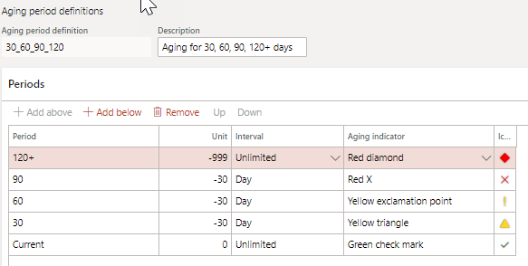

    • Stacy Black
      January 26, 2021 at 11:06 AM
      Hello Alexis,
      Your over 90 should be set to -999 Unlimited instead of -30. You may want to have the Current starting on the left, I would mark the aging to be run backwards.Ā Ā
