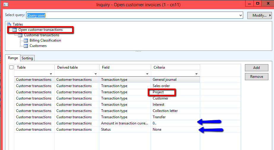

      In AX 2012 R3, when I useĀ Accounts receivable/Common/Customer invoices/Open customer invoices, project invoices are missing from the list, even though the query contains Transactions type = Project in the list, along with a few others.Ā  Ā I also see the query is using Amount in Transaction currency 0.. which would exclude all credits. i also see that it is using Status = None, which must be AX’s definition of “Open” even though I would define it as not yet settled on the customer’s account.Ā  This status field seems to have values in the dropdown list that pertain to other kinds of actions “None, Drawn, Redrawn, Protested, Honored, Remitted, Invoiced, Invoice remitted, Endorsed, and Endorsement settled. ”Ā  I see that there is a table that drives this list screen called, Open Customer Transactions.Ā Ā
      The standard AX query for Open customer Invoices
      This leads me to several questions I can use help with from the community:
      1) I thought that elements within a query in AX are usually put together with an implied “AND” condition.Ā  Ā Since this standard query is constructed with several lines of Transaction Type = something, wouldn’t the query always fail because each transaction only has one value for ‘type’?Ā  Does AX switch to “OR” operators when the field you are comparing is repeated?Ā  Why wouldn’t we use a comma separated list?Ā  I tried this and it didn’t seem to change how it worked.
      2) Why are project invoices being excluded from this list?Ā  Has anyone else experienced this problem?Ā  The Technet article has no mention of project invoices but does name sales invoices, free text and general journals.Ā Ā https://technet.microsoft.com/en-us/library/hh454994.aspx
      I have looked at the values of the three fields in the query on all my project invoices and they meet the criteria (transaction type, amount in transaction currency, status), so why are they missing?Ā  I have concluded that project invoices must be excluded from the parent table “Open customer transactions”, but I don’t know why or how or what this table is.
      3) Why would an ‘open invoices’ screen use this field “Status” to determine openness and not the closure date or the last settlement date?Ā  And why would it naturally exclude credits?Ā  Is there some other definition of “open” that I am unaware of?Ā  Technet defines this field as “The status of the bill of exchange”.Ā  Ā https://technet.microsoft.com/en-us/library/aa634902.aspx.Ā  Perhaps the parent table “open customer transactions” is already checking for whether or not the invoice has been settled?Ā  What if it is partially settled – is that still considered “open”?

      1) Using the same field on a query will use an OR operator. So your query is supposed to include records with the transaction type equal ‘Project’.

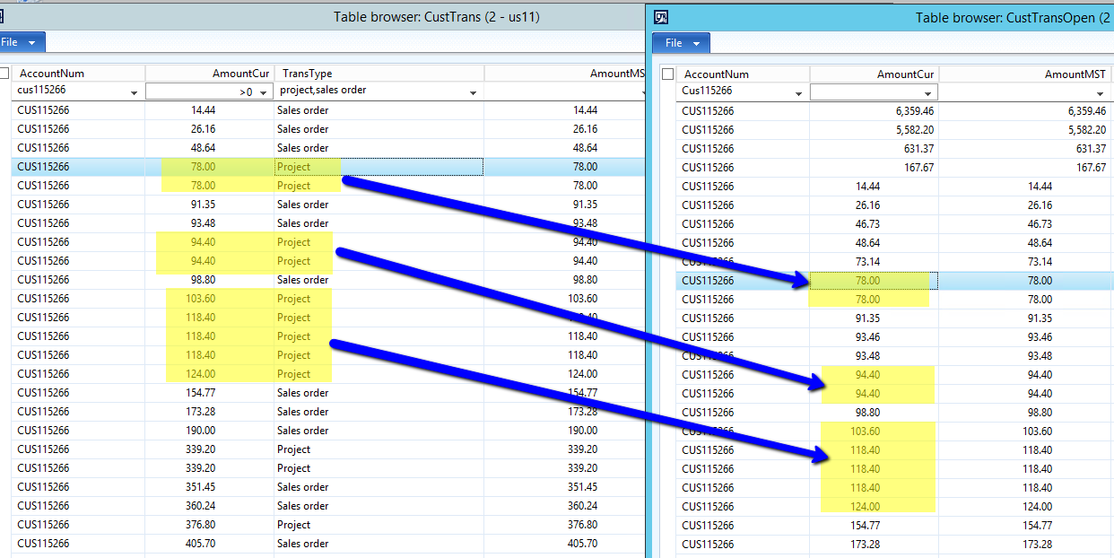

      In non-production environment, where I can access the AOT, I have filtered the table CustTrans using TransType = Project, AmountCur 0.. and BillOfExchangeStatus = None, and I get thousands of invoices.Ā  So there is definitely something else being filtered that is hidden to me.

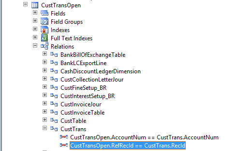

      CustTransOpen is the key here I believe.Ā  Looks like it is connected to CustTrans via AccountNum and RefRecId = Recid.Ā  I don’t see any field on CustTransOpen called RefRecId, so I’m not sure how to test to see if the project invoices that have SettleAmountCur = 0 (therefore open balance) are in CustTransOpen.Ā  Which field do I paste the Recid from CustTrans into when filtering CustTransOpen?
      AOT settings
      Instead, I looked at some project invoices with SettleAmountCur = 0 and I can match them up by their amounts and dates.Ā  Open project transactions seem to be in the CustTransOpen table.Ā
      The root of the problem seems to be this: why aren’t project invoices making the join between CustTransOpen (parent table for the Open Customer Invoices grid) and CustTrans (child table but the one used for the selection criteria for the Open Customer invoices query), yet sales order invoices join perfectly well?Ā  Ā  The records are there, just the join is broken, I think.

      ?Concerning the CustTransOpen table, it has records only for open CustTrans records.Ā  When the balanceĀ of a CustTrans record is brought to 0.00, the corresponding record(s) in the CustTransOpen table are physically deleted (automatically, by AX).
