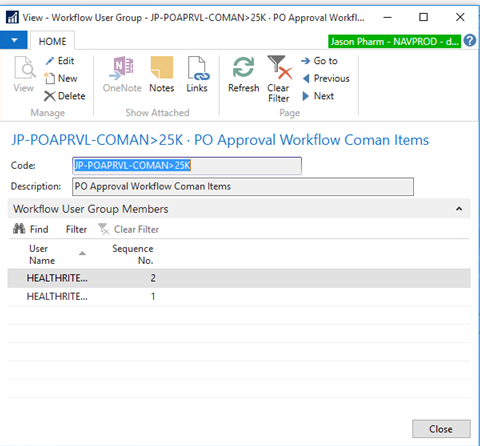

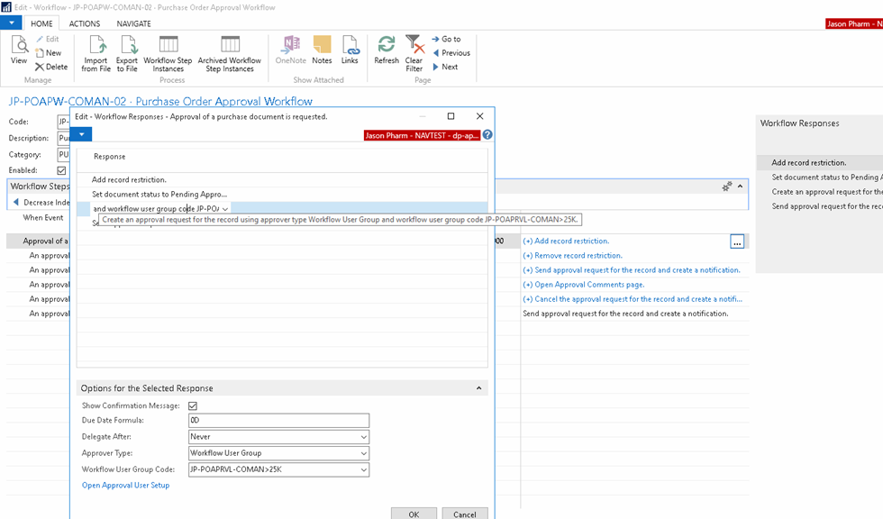

    • Aydan Golaszewski
      October 18, 2017 at 11:15 AM
      ?Here is a screen shot if will help guide you:
      And the Workflow User Group should look like this:
