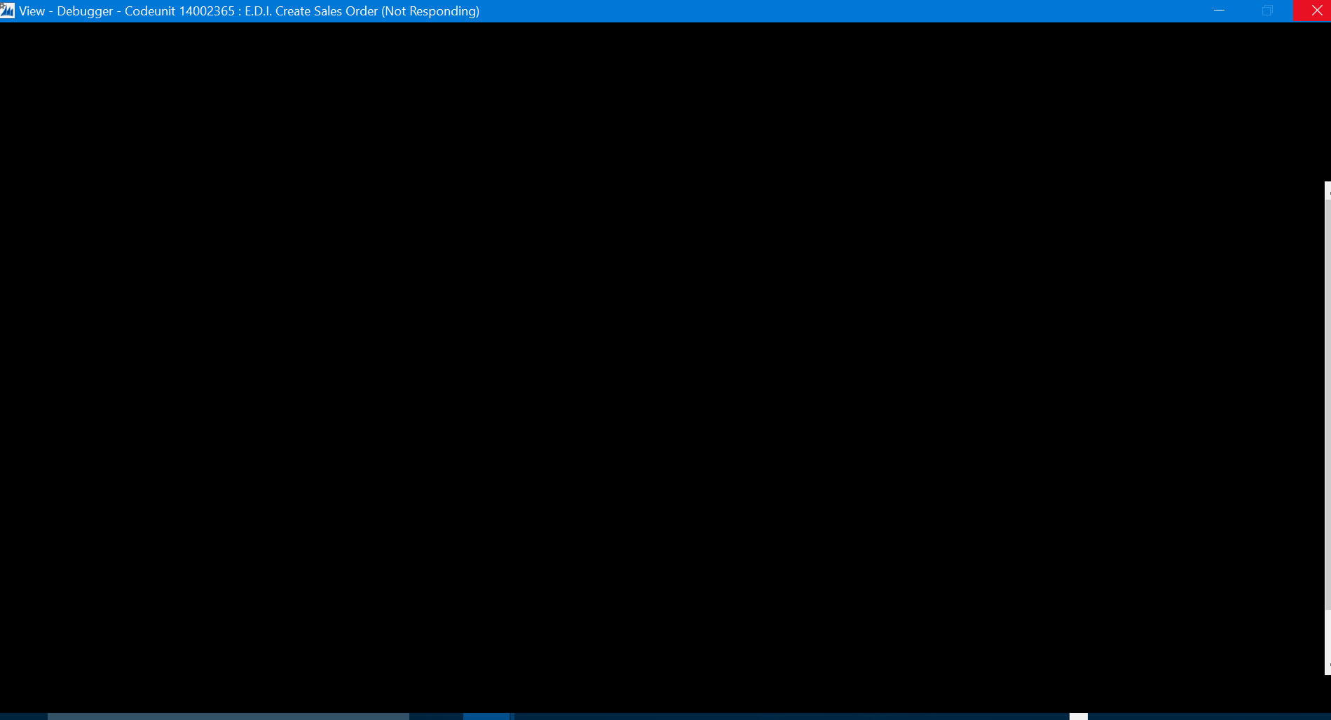

      ?Why does the NAV DebuggerĀ hang so frequently!
      (Especially when clicking the Variables button in the ribbon)

      ?I’ve had it happen on occasion, but not frequently at all.
      There might be a patch to fix it.
      The only other things I would think of, is make sure you have enough RAM, or make sure you don’t have another program that can be clashing.
      Does this happen on every machine? Or just yours?

      ?I think I’ve had it occur on different machines – I’m the only one here who would run it.
      It doesn’t hang all the time, but often enough to be frustrating….and its repetetive, meaning that the same program and error condition will make it hang each time you clear it and retry.
      Maybe next time I will pull another computer out of the closet and try.

      e.g. big arrays can be a problem with the debugger in that version.
      first solution: recompile all objects, restart nst.
      also … update to a newer CU if available or a new release.
