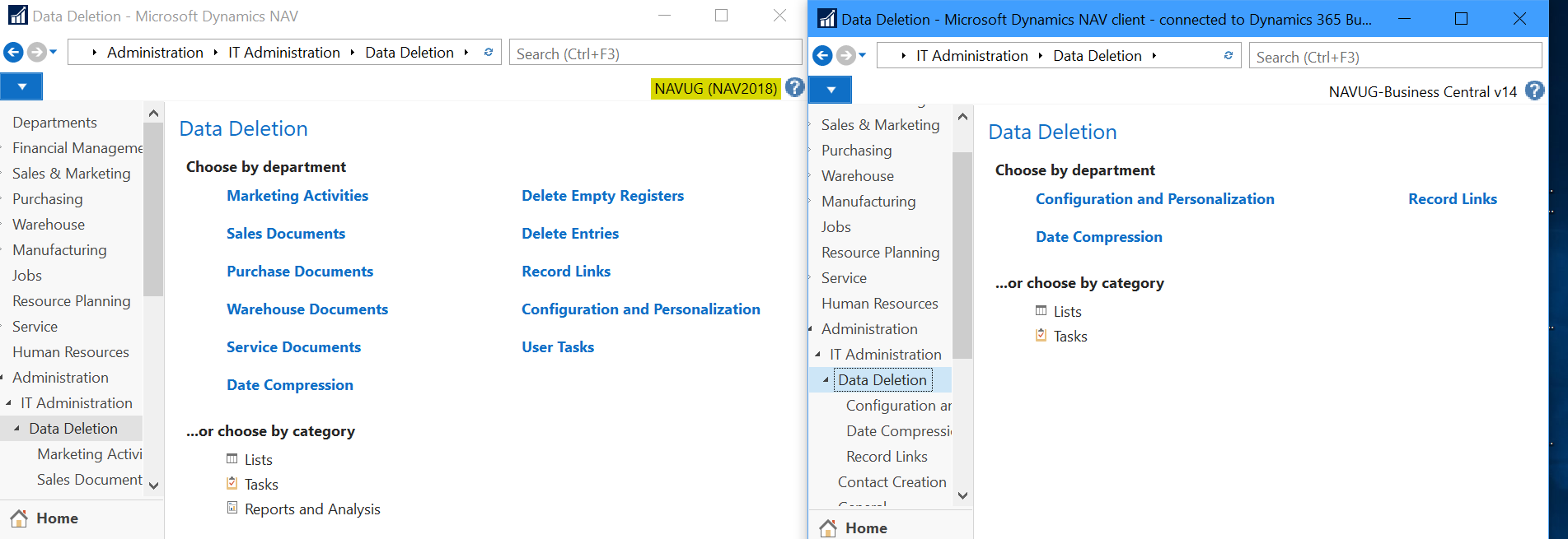

      The image below has #NAV2018Ā on the left andĀ  #D365BusinessCentral 14 (on premise) on the right.
      Does anyone know what happened to all of the Data Deletion functionality?

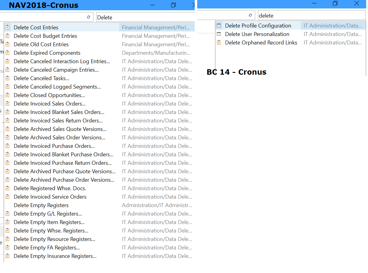

      I don’t have immediate access to your version, but did you try to search for just “delet” to get to the object captions directly? They may have moved what you are looking for to a different place in the department menu.

      Hi .Ā  My screen shots were actually from Cronus databases, but I discovered that the Delete functions are missing from our BC13 On PremiseĀ  Upgrade-Test database.Ā  It looks like the objects still all exist, but they have been removed from menus.

      I asked a few times to move them to a better place but they can be found here:
      Sales Order List Page or Purchase Order List Page
      More Options
      Actions
      FunctionsĀ
      Delete Invoiced Sales Orders (or Purchase Orders)

      Microsoft really decided to hide those functions.Ā  I definitely preferred having all of the clean-up functionality together in one place.
