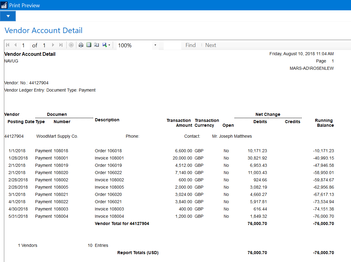

      You can run the Vendor Account Detail Report anf filter by Vendor, Date, and Document Type = Payment.

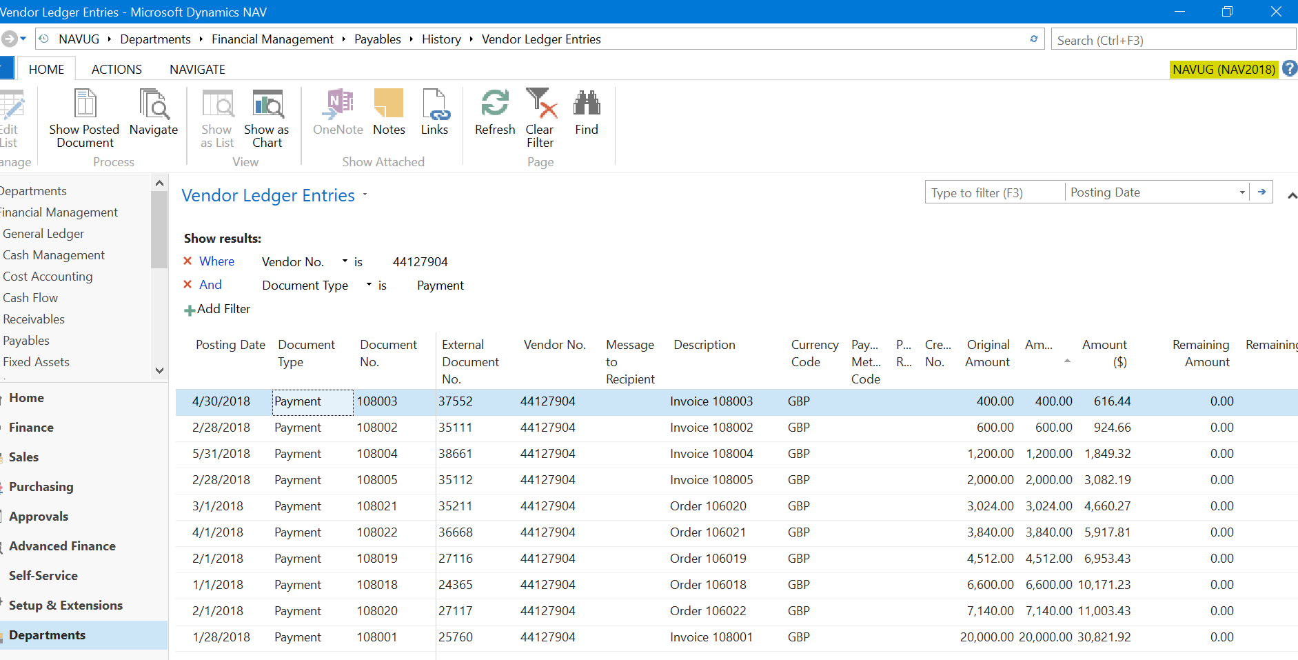

      ?You can also filter Vendor Ledger Entries by Vendor, Document Type=Payement, and a posting date range:

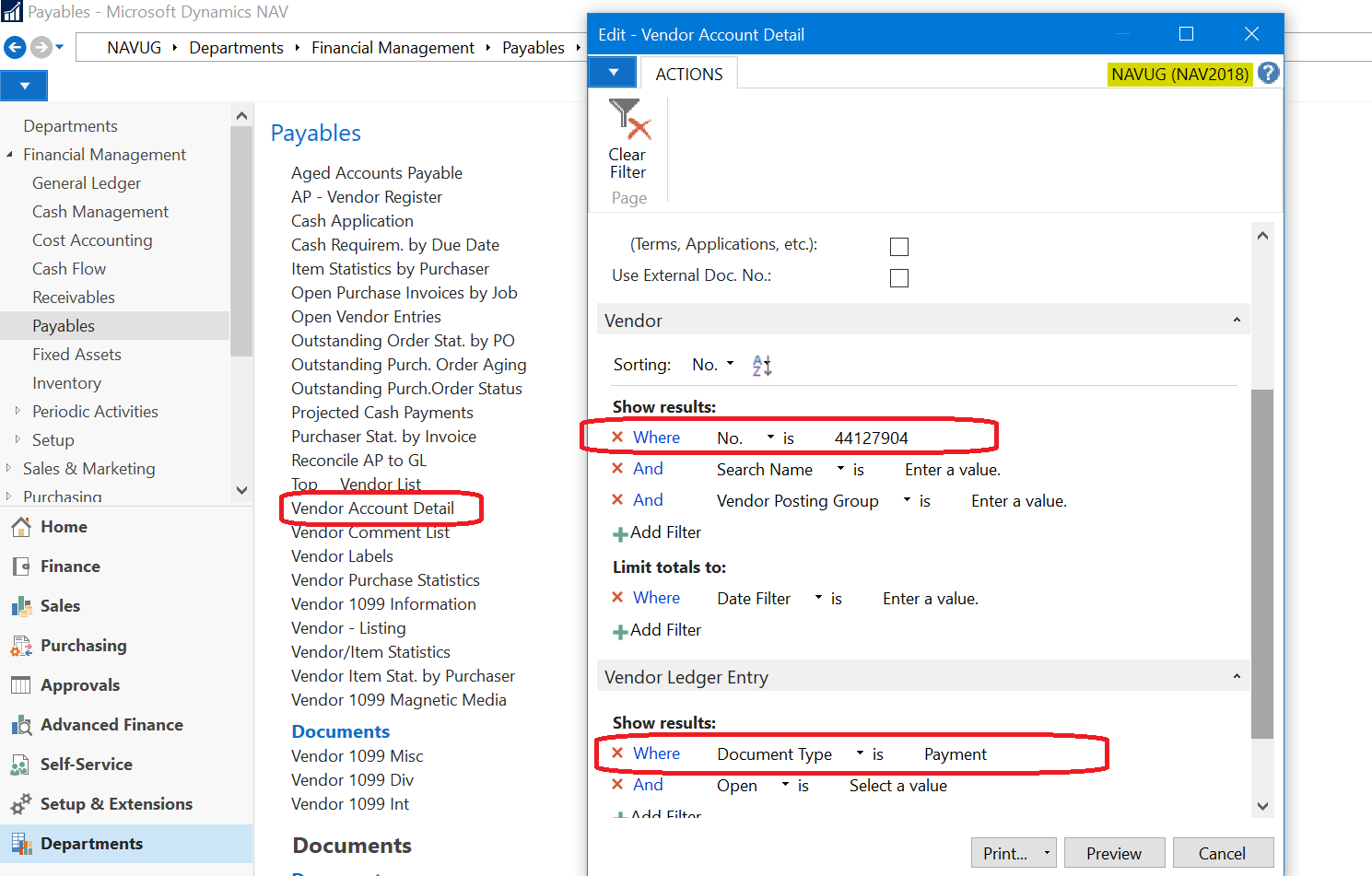

      August 10, 2018 at 11:34 AM
      ?Here’s the request page with the filters for the Vendor Account Detail Report:
