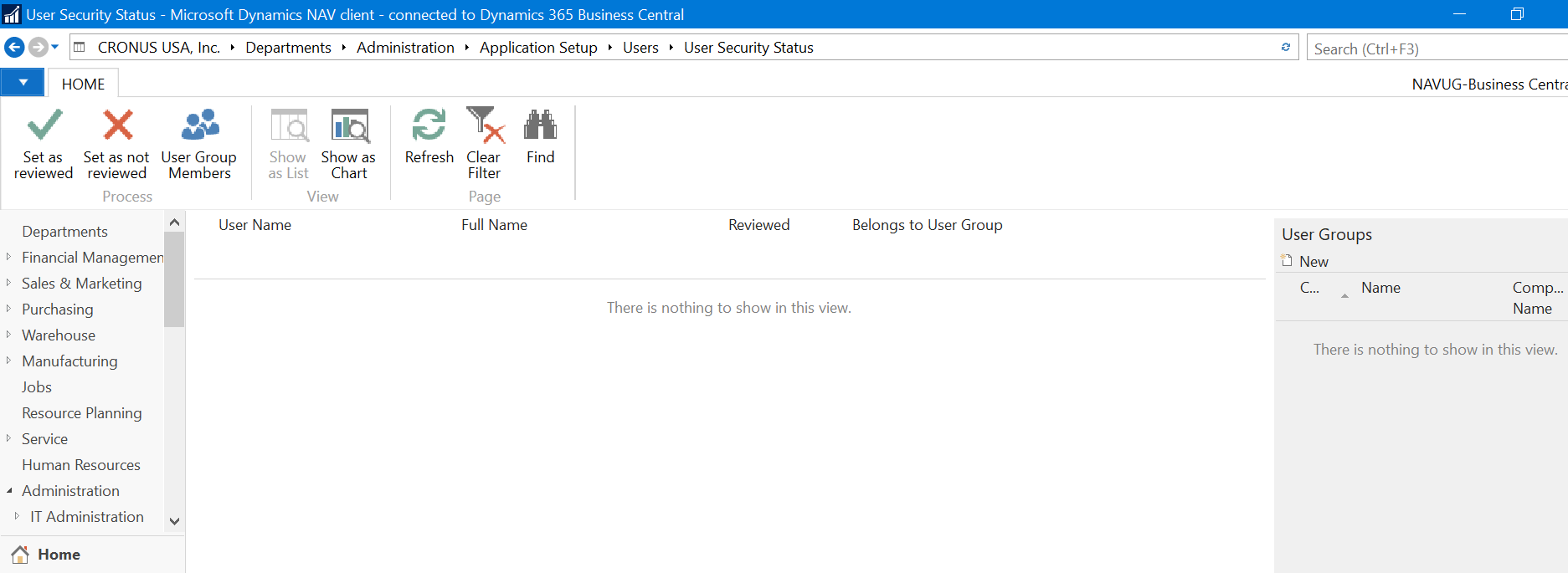

      Does anyone know how theĀ User Security Status information gets populated (TableĀ 9062, Page 9818)?
      This is a relatively new function found in NAV2018 and BC here:Ā Ā /Departments/Administration/Application Setup/Users/User Security Status

      This is pretty weird, haven’t seen this screen before.Ā  To populate this screen you need to have the Security Admin Role Center for your profile which in turn has a Cue (page 9062) that populates that page for you.Ā  Our NAV 2018 does not seem to have a profile set up called this so you might need to create a profile that has Page 9024 as the Role Center ID and assign this profile to yourself.Ā  Open NAV once and it should populate for you.Ā
      A hack to populate this page would be to go to object designer and run page 9062 directly as there is code on the OnOpenPage to Load the users.
