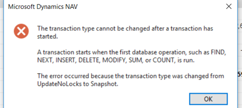

      • Something has changed in regards to TransactionType in reports if it was set to Snapshot.Ā  In NAV 2016 this was set on a few reports and basically locks the data before it runs the report so the report will balance.Ā  An obvious example of this is account schedules.Ā  If you don’t lock the G/L Entry and Budget tables while you are getting the data there could be incomplete G/L entries that are brought into the data (I have seen this before).Ā  In NAV 2017 it seems the fix is to change the TransactionType from Snapshot to the default which is UpdateNoLocks.Ā  There was some different code as well in NAV 2017 so maybe they addressed this issue in some other way not sure.Ā  The only out of the box place I have seen this is when in account schedules if you go to Accounts Overview, Actions, Export To Excel, Create New Document.Ā  The error is scarey as can be seen here:
      Ā Ā Ā Ā  The fix I used is to go to report 29 and change the TransactionType property to UpdateNoLocks

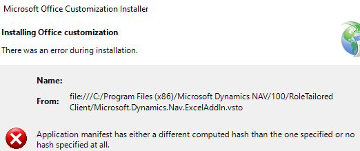

      • The Microsoft Dynamcis Add-in is not working for us.Ā  When opening excel (where it tries to load this add-in) we get this error:
      Ā Ā  So for now we have disabled the add-in and will not use this feature which most people in our company don’t even know about anyway.Ā
