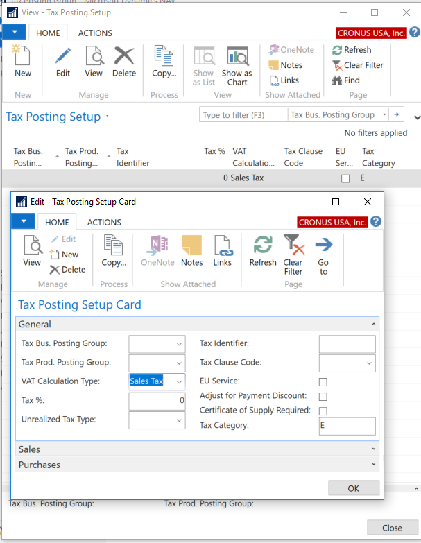

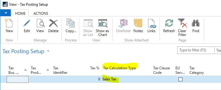

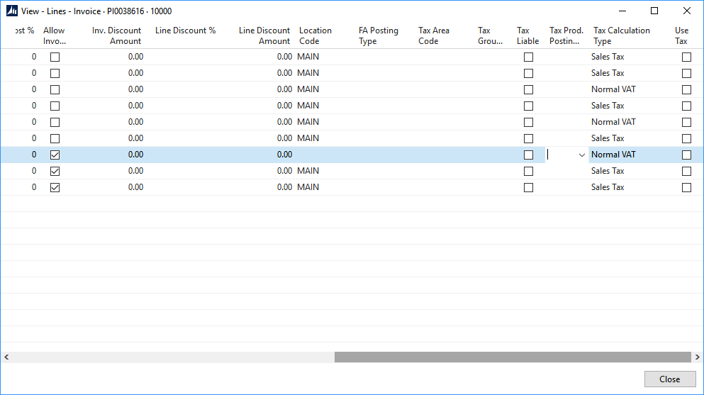

      Could someone tell me how this field is populated and how can you change it?Ā  I need the fields to be the same and I don’t know where Normal VAT is coming from.
      Screen shot

      Pam, this is populated from Tax Posting Setup which takes the Tax Business Group from your customer or vendor and combines it with the Tax Product Group from your item.
      The default is Normal VAT so if you don’t change the VAT Calculation Type is this setup it will not be Sales Tax.

      Thanks Kim.Ā  That is the crazy thing, it is Sales Tax.Ā  We figured out a work around so all is good.

      When you setup a US company, make sure Tax Posting Setup has one record with “Tax Calculation Type” as “Sales Tax”. This will calculate the sales tax on the documents going forward
