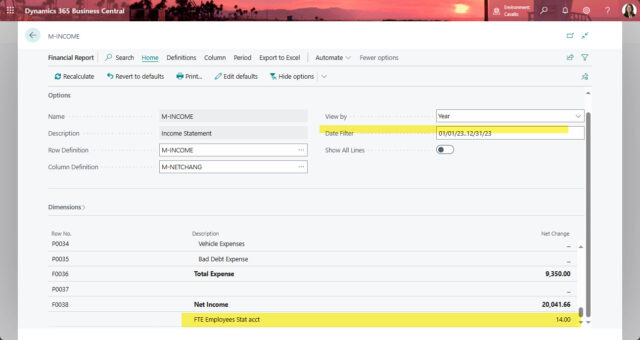

    I am starting to use Statistical Accounts in Business Central. When adding to the Row Definition of a Financial Report, I choose Totalling Type = Statistical Account and enter the account number in the Totalling field. I don’t get a value when I Recalculate the Financial Report. Is there something I’m missing? I can see the value posted in the Statistical Account Ledger Entry window.

    Check your dates for the report and make sure you have entries posted within the date range to the statistical account. I just tested on my end and no issues. If you want to connect to review together let me know.

    Thank you for your response, Kristen. I think my problem was with the Analysis View that I was using for the report. This is new to me so I going to keep testing different scenarios.
