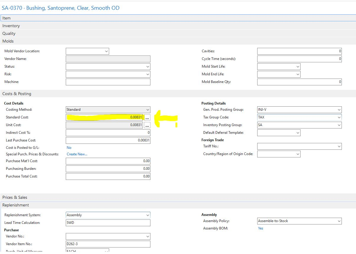

      I may be crazy but I would have sworn that you were blocked from entering anything in the standard cost block in the item card if there was a BOM attached to the part?
      Is this new in NAV 2018 ? or has it always been this way?

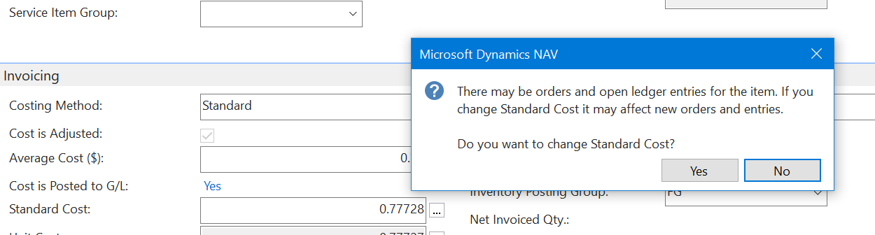

      April 17, 2019 at 4:44 PM
      It is editable in NAV2013R2 (there is a BOM for my selected item).
      We get a pop-up warning if we try to change the Std. Cost.

    • Grant Slemp
      April 17, 2019 at 6:08 PM
      ?It is editable in NAV 2016 as well, just tried it and got the same popup msg as Lewis.

    • Michael Carr
      April 18, 2019 at 8:49 AM
      Grant,Ā
      Thanks for the response.
      I think it would be a good option to allow or a customization to add.
      If I can find the time I will experiment as I wonder if just setting a standard cost on the item card will create an imbalance with the cost share reports since the system can’t know what the material costs vs. capacity breakout is?
      And will a standard cost worksheet global cost writeover the manually entered standard cost?
      Thanks again.Ā

    • Amanda Mayer
      April 18, 2019 at 11:45 AM
      You are correct that it is editable, and it is definitely dangerous. If you change that field and the revaluation journal is not run, your inventory will not be correct.??

    • Kevin Fons
      April 19, 2019 at 7:51 AM
      We commonly do a very simple modification that will prevent changing the standard cost on the item card if there are any value entries present for the item and steer the user to the standard cost worksheet.
