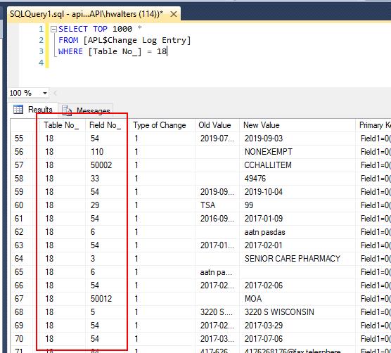

      Is there a SQL table that will give me a cross reference of NAV Table No, NAV Table Name? Also, NAV Field No, NAV Field Name?
      For instance, when I query the change log table, I only see references to [Table No_] and [Field No_], but no readable names. Several tables have these references.
      I can get the readable name in the client or look it up manually in the Dev Environment, but I would like to join it in SQL. Does anyone know a spot where I can find this information?

      The Object table has the table info you needĀ
      select * from [Object]
      Type = 1 for table
      The field level data I’m not sure where it comes from though (other than the virtual field table in the object designer)

      That is just what I was looking for! Can’t believe I didn’t find that myself. Thanks!
