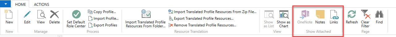

      We don’t use any of the options in the Show attached Group on the home tab of our ribbons. Has anyone figured out how to remove options and or groups from the ribbon. I am having no trouble with options from other tabs. Those I can control fairly easily in an extension.
      Example of Show Attached in a Ribbon

      There is a “LinksAllowed” property on pages. When you set it to “No”, it’ll get rid of the Show Attached section of the Ribbon.

      How do I access the “Links Allowed” property in an extension?

      Here is the documentation on how to set the LinksAllowed property:Ā https://docs.microsoft.com/en-us/dynamics365/business-central/dev-itpro/developer/properties/devenv-linksallowed-property
      I’m still on NAV 2017, but I believe you would just add it to the page properties in your page extension.

      Unfortunately, it is not available in extensions. However, I did suggest it to Microsoft today.
